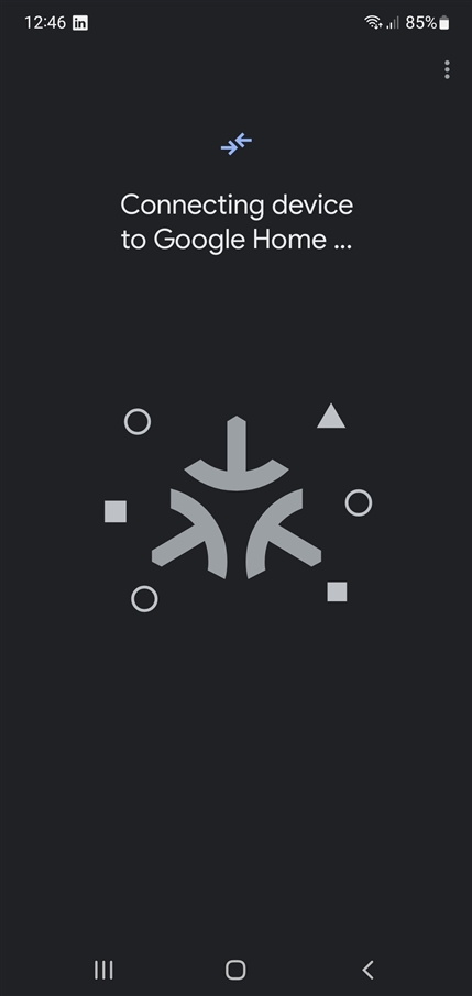

But as soon as I add another endpoint-3. The nRF-5340-DK restarts/crashes unexpedlty and commissioning falis.
Endpoint-0 -------------- Root
Endpoint-1 ------------- MA-LightDimmer
Endpoint-2 -------------- MA-OnOffLight
Endpoint-3 -------------- MA-OnOffLight
I am using nRF Matter-Light-Bulb sample and trying to add new endpoints (endpoint-3) to the project. The project compiles and flashed to my nRF-5340-DK board. When I try to connect/commission it crashes/restarts the nRF-5340-DK board and On Google-Nest-Hub2 the last status is 'Connecting device to Google Home'. As you can see from the error logs. the device restarted unexpectedly.

- I didn't made any-other firmware change to the default(base) matter-light-bulb sample. Other than, adding two new endpoint-2 and endpoint-3 using 'west zap-gui' and generating the updated files using 'west zap-generated' and the project compiles.
- The restarting/crash always happens when endpoint-3 is used.
