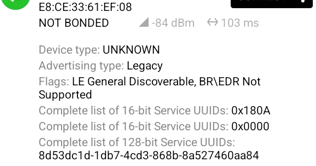

I am trying to do an OTA update of the firmware on my device. I am using Nrf Connect SDK 2.1. I followed some of the tutorials and setup the device to advertise the SMP UUID.
Using the Nrf Connect Mobile app I can see the device after the scan as below. The SMP UUID is observed. However when I use the Device Manager App I don't see the device even if I untick "Only devices advertising SMP UUID". Yet I do see other devices getting picked up. What configuration is causing this difference between the two apps.
