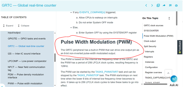

How is the current consumption for GRTC PWM OUT of nRF54L15? Thanks.
  • Hi Susheel
    Sorry for the unclear description. We want to know the current consumption for enabling GRTC with PWM output. Many thanks.
  • We have not measured this ourselves, yet and it seems like these numbers for peripherals are not available in datasheet also to be able to calculate ourselves.
    I will try to ask my colleague who had worked on some power consumption stuff on this chip to know if he knows more. I will come back to you mostly tomorrow with more info if possible.
  • I see that I missed to see the system on idle current with GRTC is mentioned in the front page of the datasheet
    For the PWM details I need to enquire this internally with the team that might have access to the info. But I need to create an internal ticket. I will be back to you when I have some more info from them.
  • Sorry to revive an old thread. I'm replying here as I'm interested in the answer to OP's question (Current consumption of GRTC PWM Out) and it didn't seem like it was definitively answered. Any updates here?
  • not with the GRTC and PWM combination. Should be able to test it yourself with simple test like with below
