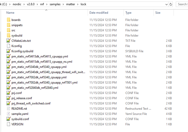

  • Hi Ankit,
    It's actually possible to make pm_static file for each board. Just name it pm_static_*boardname*.yml
    You can take a look at our sample for reference:
  • Hi Hung,
    I see. That should resolve my concern.
    So what I understood is that the pm_statuc.yml file is the only way to define a custom flash partition when the MCUBoot is enabled.
