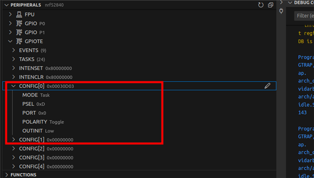

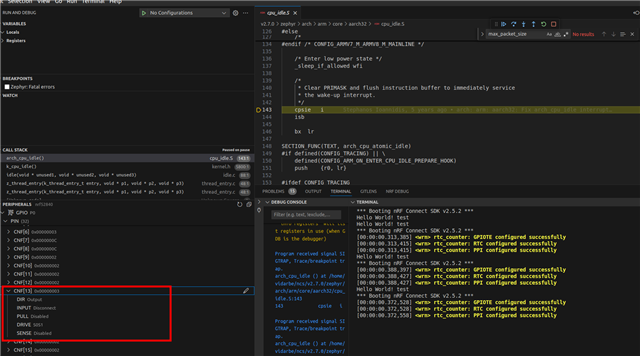

Trying to get an output GPIO to toggle using the RTC and PPI peripherals
Hello. I'm trying to toggle a GPIO pin at a predefined frequency in order to measure the accuracy of out RTC clock. This code uses the GPIOTE, RTC, and PPI peripherals in order to avoid firmware callbacks being used. This code compiles, and everything seems to be configured properly, but nothing is output on the proper GPIO pin. Any advice is appreciated.

    nrfx_gpiote_output_config_t config = {
        .drive = NRF_GPIO_PIN_S0S1,
        .input_connect = NRF_GPIO_PIN_INPUT_DISCONNECT,
        .pull = NRF_GPIO_PIN_NOPULL,
    nrfx_gpiote_task_config_t task_config = {
        .task_ch = 0,
        .polarity = NRF_GPIOTE_POLARITY_TOGGLE,
        .init_val = NRF_GPIOTE_INITIAL_VALUE_LOW,
    err_code = nrfx_gpiote_output_configure(TOGGLE_PIN, &config, &task_config);
    if (err_code != NRFX_SUCCESS) {
        LOG_ERR("GPIOTE output configure failed: %d", err_code);
        return;
    LOG_WRN("GPIOTE configured successfully");

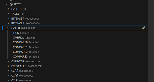

static void configure_rtc(void) {
    nrfx_rtc_config_t rtc_config = NRFX_RTC_DEFAULT_CONFIG;
    rtc_config.prescaler = 4095; // RTC frequency: 32768 Hz / (prescaler + 1) = 8 Hz
    nrfx_err_t err_code = nrfx_rtc_init(&rtc_instance, &rtc_config, rtc_handler);
        LOG_ERR("RTC initialization failed: %d", err_code);
        return;
    nrfx_rtc_tick_enable(&rtc_instance, false);
    // nrfx_rtc_overflow_enable(&rtc_instance, true);
    nrfx_rtc_enable(&rtc_instance);
    LOG_WRN("RTC configured successfully");
