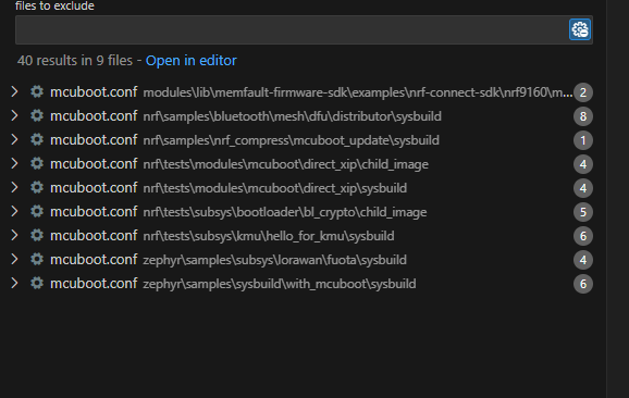

  • MCUBoot might have the WDT enabled in it. If you have CONFIG_WATCHDOG=y in your mcuboot.conf file
    Then disable it by setting it to CONFIG_WATCHDOG=n (or set this anyway to n in this file just to be sure)
  • I have no mcuboot.conf file in my project and I do not have a sysbuild folder, nor a child_image folder.
    What should I add and where?
