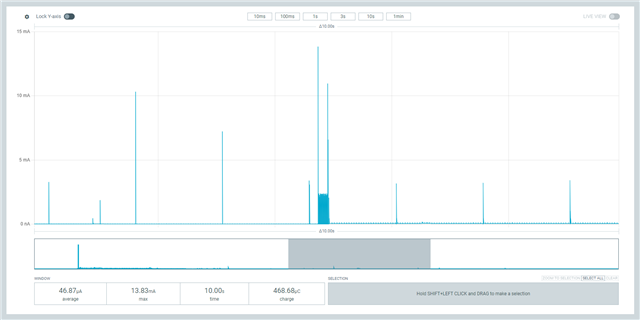

We are working on an integration between a nRF52832 and ST LIS3DH accelerometer on our custom board, using SDK 15.2.0 with SoftDevice and BLE enabled, and have observed an increase in idle current draw after the first interrupt from the accelerometer after system power-up. As part of our analysis, we have isolated the accelerometer from the nRF and manually inject the interrupt on the nRF pin, as well as commenting out interrupt handling code and making the interrupt simply toggle an IO for observation with an oscilloscope, and still observe the increased current draw.
Below is the code we are using to initialize the interrupt pin. We have tested by setting the interrupt in both the low and high accuracy mode and observed a correlated ~5uA reduction in current by using the PORT interrupt mode, however the increase in current after the interrupt event is still present.

Below are two charts showing the current increase with the interrupt beginning at the ~90th data point. These interrupts were triggered manually using an external jumper, and the interrupt service was modified to perform no accelerometer interaction via TWI and simply toggle GPIO 22 for 1ms to confirm the interrupt triggered.

    If I read your graphs correctly, you are going from approx. 20 uA -> 60 uA after the interrupt has occurred.
    pin is configured with PORT, with emulated edge triggering, but you are also seeing similar behavior when using "hi_accuracy" (ie. GPIOTE.IN).
    What is the sampling rate of your current profile? I fear that aliasing is causing the current consumption curve to be smoothed out, so that we loose potential wake-up events. Do you have access to a PPK2 or similar which has a higher sampling rate?

  • Hi Håkon. You are correct, data is being aliased due to the sampling rate in the previous recordings. Attached are a .ppk2 file of the recording of a test similar to those above at 100kS/s, as well as a screenshot showing the transition period before and after the interrupt event at approximately 22.7s.
    No debounce is being applied to the manually triggered interrupt. The ~2mA current spikes for ~0.2s after the interrupt can be attributed to this as a GPIO attached to a level shifter with pullups is being driven to observe and confirm the interrupt is triggered. The ~1.5s period current spikes are another processor on the board waking up periodically. I also wrapped the nrf_pwr_mgmt_run() call in main() with a GPIO toggle to observe wake events, and did not observe a difference before and after the interrupt event.
