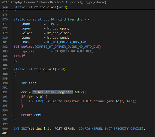

Can't use bt_enable when I use sysbuild and enabled IPC_RADIO
Hi, Team.
We are currently using NCS v2.7.0 with the sysbuild approach on the nRF5340. We referred to the nrf/sample/matter/lock code and copied its sysbuild configuration (as we need Matter support in the future).
However, we encountered an issue:
  • When enabling the network core IPC_RADIO, the bt_enable function in my code fails to execute properly. The underlying hci_core returns -11 (EAGAIN or resource unavailable).
  • When I disable IPC_RADIO and instead only use SB_CONFIG_NETCORE_HCI_IPC=y, the Bluetooth functionality works correctly.
Question:
1 - Did I miss any configuration steps to enable IPC_RADIO and  use bt_enable() work properly?
2 - Both Bluetooth and IEEE 802.15.4 are supported, so why does the Matter sample code use IPC_RADIO for the network core instead of Multiprotocol_RPMsg?
     Is there any particular reason for this?
    Thanks for checking with us.
