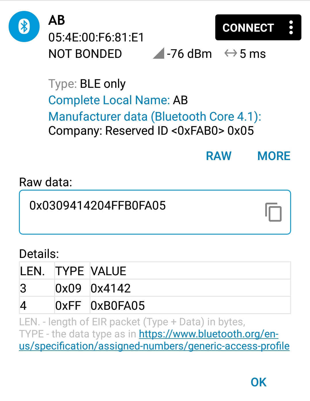

I am developing a firmware version for nrf51822 based on Softdevice S130 (old v8.1) and Timeslot API. Currently, I can freely transmit and receive packets while the softdevice is active, running, and actively utilizing the radio interface.
Issue: while sending packets via the Timeslot API, the 25th byte of the packet is never correctly set, it doesn't have a fixed value, and floats within a range of values (e.g. from 0xBB to 0xCC).
Question: Is the 25th byte of a timeslot packet maybe the CRC field?

The issue happens only when we send a packet via the timeslot API. The packet is configured on the fly on a vector of size (e.g.) 25, and is formatted following BLE standard, so that nRF Master Control Panel and a custom android application can receive and parse the packet successfully. Flags or scan response are not implemented yet, because they are not needed for now. The timeslotted radio is configured to send over advertising channels, with default advertising parameters (default CRCINIT, ADV_ADDRESS, WHITEEN enabled, so that we are practically sending custom advertising packets).

  1. On further investigation, the issue does not depend on the length of the packet; we can send more bytes, but from the 25th onward never show correctly when received.
  2. The data is written inside the Manufacturer Data field (type code 0xFF), and shows correctly up to the 24th byte.

Adding screenshots of nRF Master Control Panel (forgot to add it since the beginning). image description
