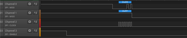

However, when I add the lines in Kconfig, the firmware does not start. The first thing I do in main() is to set a LED using GPIO, this is never lit.
When debugging, the code never reaches main(), and the VSCode plugin hangs when I attempt to pause execution.
I thought the problem could be related to the MISO pin being the same as the reset pin, but the issue persisted even if I deleted gpio-as-nreset in the Devicetree.
Is there some configuration issue here?

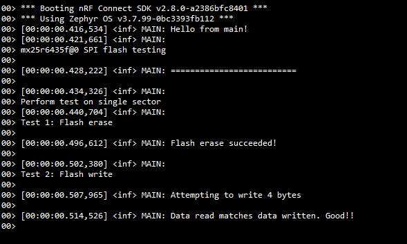

I tried the exact same flash on the nRF5340DK. There, QSPI is used instead of normal SPI like on our board. This works just fine.
