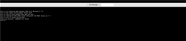

  • Hi Håkon,
    We performed the following steps -
    1. Enabled CONFIG_NRF700X_RADIO_TEST_COMBO=y in prj.conf file in ncs/nrf/samples/wifi/radio_test
    2. Added RTT logs in ncs/nrf/samples/peripheral/radio_test/boards/nrf7002dk_nrf5340_cpuapp.conf
    3. Built ncs/nrf/samples/wifi/radio_test for nrf7002dk_nrf5340_cpuapp
    On following the above steps, we are able to run the WiFi test commands via RTT but getting 'not found' errors when trying to run BLE commands (screenshot below).
    Also, validated that on enabling CONFIG_NRF700X_RADIO_TEST_COMBO, separate network and app core builds are being generated.
    Anything we might be missing?
    Ashish
  • Now you have two separate images running on each core. Your app_core is running wifi/radio_test and the network core is running peripheral/radio_test. These two do not communicate to eachother, meaning that you need to open up a communication channel to each core.
    You need to connect to the network core (in JLinkRTTViewer: NRF5340_XXAA_NET) in order to issue bluetooth radio_test commands.
