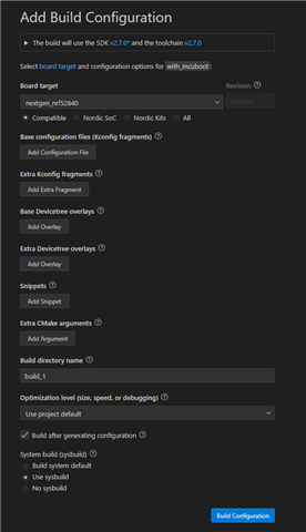

When i build with_mcuboot using the vscode extention and choosing the nrf52840dk/nrf52840 the build compiles normally.
But when i choose the custom board here the nextgen_nrf52840 which the extention correctly identifies as an option.
But when i build it fails with this message:

  • Hi Wouter,
    Have you added the path to the board folder to NCS extension setting ?
    It should look like this:
    And when you select the board configuration, it should appear as "Custom boards":
    I tried to compile your project here but run into other issue than the board not found issue:
  • I had not tried to add the path to the board folder of the NCS extension setting.
    Having done that now it also didn't show up in custom boards.
    But moving my boards folder out of my project folder and into the west folder did make the board appear in the custom boards tab.
    This however did not build either.
    What did work was not using sysbuild and instead using "build system default" where it did find our board even if it was in the folder of the project that we tried to build.
