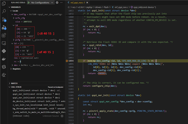

I am attempting to run the Matter Template app sample on the Adafruit Feather nRF52840 Express board.

I also created .overlay file with the following content:
	chosen {
		nordic,pm-ext-flash = &gd25q16;
I built the application using a configuration for the adafruit_feather_nrf52840 target with sysbuild enabled, and the build process completed successfully. After flashing the firmware to the board, it does not show any logs via UART or RTT, and the device does not advertise itself. I suspect the application is not running correctly.
Could you help me identify what might be causing this issue or guide me on how to proceed with debugging?
