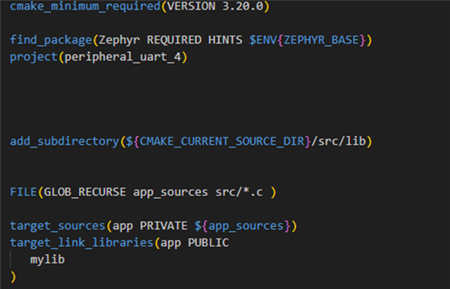

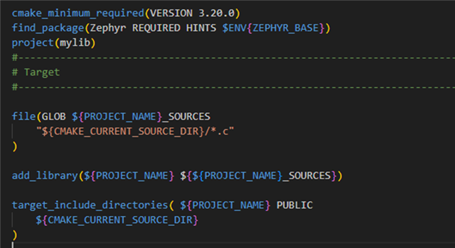

I want to create a static library in the application layer, but this library will contain nrf related header files, which will cause cmake to not compile properly
main.c  CMakeLists.txt:
lib CMakeLists.txt:
Is there any way to help it find this header file? We are using version v2.8.0, vscode,cmake

    Thank you for sharing.
    The problem seems to be in the creating of the static library, as it uses make, as described in the docs:
    https://docs.zephyrproject.org/latest/samples/application_development/external_lib/README.html
    Any includes must be set here: https://github.com/zephyrproject-rtos/zephyr/blob/main/samples/application_development/external_lib/mylib/Makefile
    What is your intended use with this static library?
