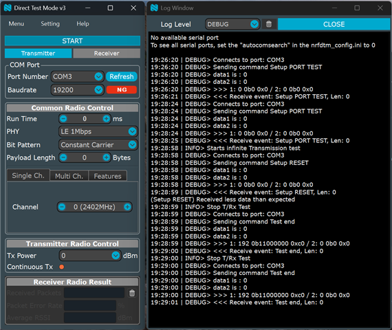

We are currently mass producing nrf52833. However, there is a problem with BLE communication. The defective product does not appear in the BLE search list at all. The failure rate is about 20%. We confirmed that it works well when we replace only the new nrf52833 on the problematic board.
We purchased 1 reel (3000 units) of nrf52833, and there was no problem up to 500 units.
We want to check if the RADIO module in the nrf52833 is broken or if it is a soldering problem. Is there a way to know if the RADIO module inside the nrf52833 is working properly?

And, the output result is as follows.
RADIO state: 0
NRF_CLOCK : 0
RADIO is disabled.
Device ID 0: 0x4D2EA0AC
Device ID 1: 0x8CDE800E
Production Test Signature 0: 0xBB42319F
Production Test Signature 1: 0xBB42319F
Production Test Signature 2: 0xBB42319F
Info Package: 0x00002004
Info RAM Size: 0x00000080
TEMP A0: 0xFFFFF356
TEMP A1: 0xFFFFF356
Radio module power is on
