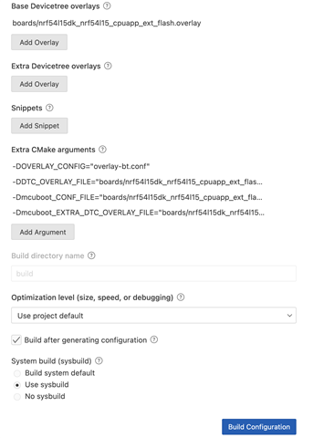

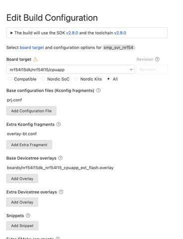

To reproduce my issue, just build the sample out of the box, with the following build configuration :
- board target : nrf54l15dk/nrf54l15/cpuapp
- base configuration files : prj.conf
- extra Kconfig fragments : overlay-bt.conf
- base devicetree overlays : boards/nrf54l15dk_nrf54l15_cpuapp_ext_flash.overlay
- system build : sysbuild
Build and flash this on nrf54l15dk and try to upload the firmware using the device manager app, using a dfu_application.zip file.
