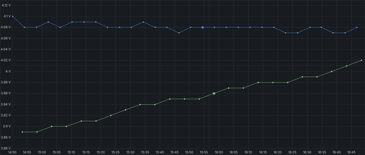

    I have an evaluation done too with a Solar-panel and a 1000mAH LiPo using a customized board.
    Pitfall 1:
    When the Sun is bright the floating voltage rose over the cut off Voltage and the nPM1300 protection hits
    Pitfall 2:
    When charging the current-microamp = <100000>; must set below the threshold where voltage drops below the 4.4V
    Pitfall 1 solution. We add a diode in the power path which cuts 0.7V from the floating voltage (e.g. 5.6V(float) - 0.7 = 4.9V) not trigger the protection.
    With this config we was able to have good charging setup.
    Green, is the nPM1300 Blue, conventional solar charging module always charging.
    Hope that helps.
    Chris
