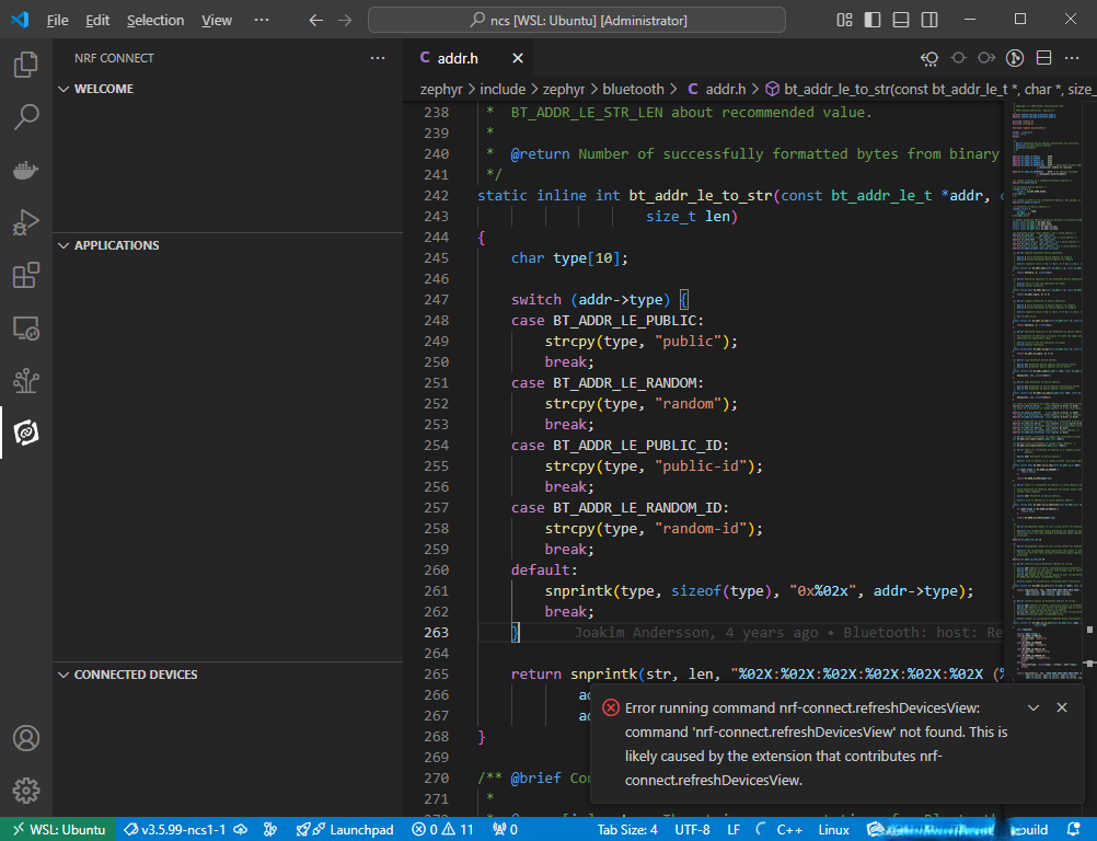

  • I don't know if it's related or not, but lately I'm experiencing similar issues in which I cannot see anything under the nRF Connect extension tab (I'm using VSCode under WSL2). If I click the "Refresh" button under the Connected Devices an error appears like in the picture:
    For me it works just disabling the extension, reloading the window and enabling it again. But it's annoying to do this every time I open the editor. Can you try reloading the extension?
