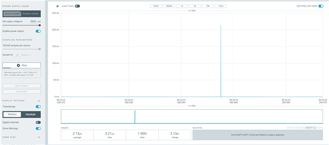

Additionally, is this behavior normal?
When in Source Mode and setting the supply voltage to 5000mV (well the USB Voltage) it gets super low nA values when nothing is connected, which is to be expected and really nice! :)

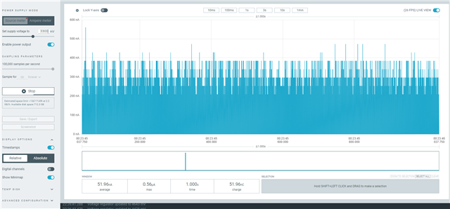

However, when I set the voltage to 3300mV it jumps up to 300nA:
I just wanted to ask this as a sanity check and to see if this is expected behavior and if the device offers any protections for short circuit (like if you happen to have a spike above 1Ampere at 5V)

    The behavior you see when nothing is connected here is expected. Some jitter at very low currents must be expected due to the level shifters on the PPK2 if I'm not mistaken.
