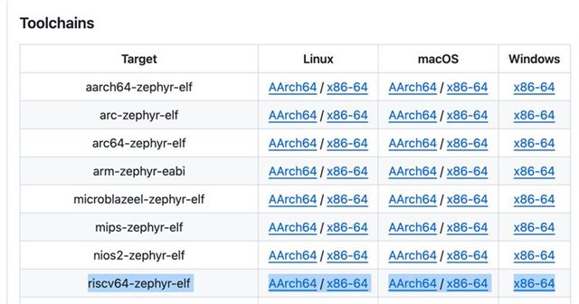

  • Hi
    The file is downloaded and copied into the bundle from here: https://github.com/zephyrproject-rtos/sdk-ng/releases/tag/v0.17.0
    Does Norton trigger when downloading/unzipping the file directly as well?
    Simon
