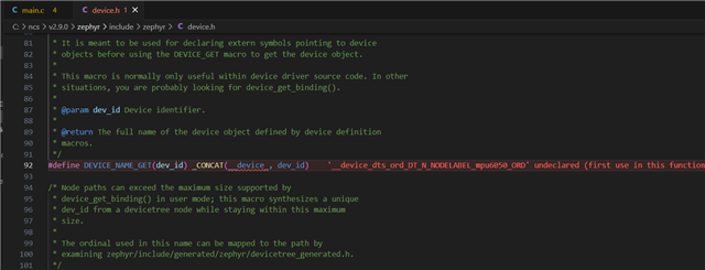

'__device_dts_ord_DT_N_NODELABEL_mpu6050_ORD' undeclared (first use in this function)

error in device .h file how to rectify

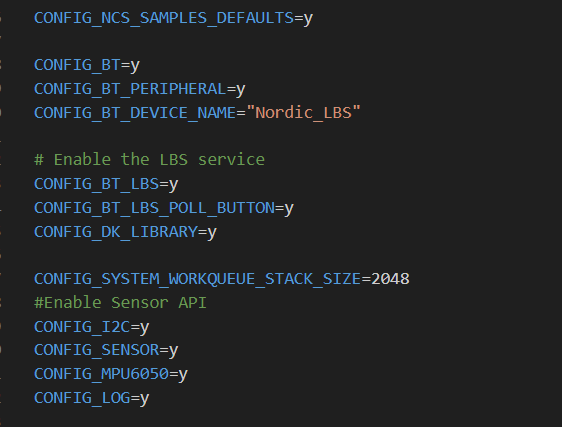

  • Might be a missing config option in prj.cfg, like CONFIG_SENSORS=y

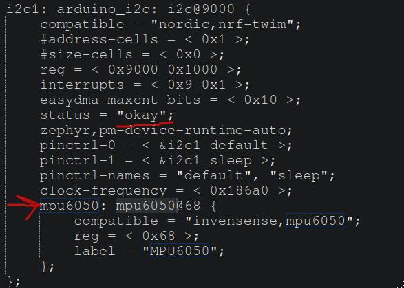

  • Can you verify from build/<project>/zephyr/zephyr.dts that the DTS node is there?
  • This is the code in zephyr.dts file .I dont know exactly what to check.

                i2c1: arduino_i2c: i2c@9000 {
                    #address-cells = < 0x1 >;
                    #size-cells = < 0x0 >;
                    reg = < 0x9000 0x1000 >;
                    interrupts = < 0x9 0x1 >;
                    easydma-maxcnt-bits = < 0x10 >;
                    status = "okay";
                    zephyr,pm-device-runtime-auto;
                    pinctrl-0 = < &i2c1_default >;
                    pinctrl-1 = < &i2c1_sleep >;
                    clock-frequency = < 0x186a0 >;
                    mpu6050: mpu6050@68 {
                        compatible = "invensense,mpu6050";
                        reg = < 0x68 >;
                        label = "MPU6050";

  • I edited your comment to add the code in a Code Box, to make it a bit tidier.
    Here is what Im looking for:
    I'm just checking that the MPU is there and that its peripheral has been enabled.
    It is, so that looks okay.
    Now that we know you got both Kconfig and DTS, it is a bit harder to guess what is wrong here.
    Can you post the full build log next? Using the Insert->Code feature.
