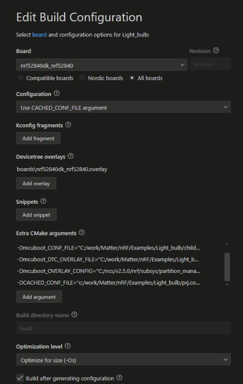

I use nRF52840 DK (SDK 2.5.0), all my attempts to raise examples for "Matter", were not crowned with success (for example projects: Light Bulb, Light switch).
Everywhere during assembly the same problem, flash memory overflow: region FLASH' overflowed by 1966 bytes (and this is regardless of which of the configuration files I use prj.conf or prj_release.conf + Optimization level: Optimize for size).
I also tried to reconfigure the project to use external memory for work (for this case, those examples), but obviously my knowledge is not enough for this.
1) How can I correctly reconfigure the project to use external memory instead of Flash?
2) I know that since SDK 2.8.0 you have removed Zigbee support for nRF52840. What about "Matter"?
I added changes to the .conf file like this:
CONFIG_FLASH=y
CONFIG_SPI=y
CONFIG_NRFX_QSPI=y
CONFIG_NORDIC_QSPI_NOR=y
CONFIG_FLASH_PAGE_LAYOUT=y
CONFIG_FLASH_MAP=y
and also included a file like pm_static.yml in the project root:
partitions:
config_partition:
address: 0x12000000
region: qspi_flash
firmware_partition:
address: 0x12100000
region: qspi_flash
But this did not give any result, when building the project still tries to work with a regular flash, and not an external one.
I have attached the current .conf, .overlay, .dts file.
