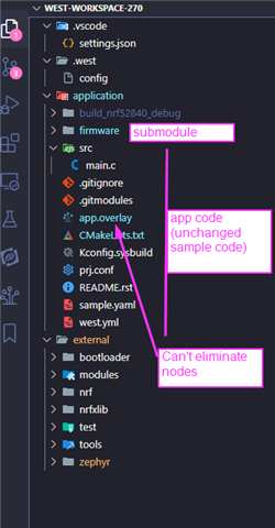

deleteing default device tree nodes
piggying-back on BT nus shell sample (workspace project), I try to define my own dt nodes.
// *** These two are deleted gracefully ***
/delete-node/ &spi0;	// conflicts with i2c0
/delete-node/ &spi1;	// conflicts with i2c1
// *** I want to remove all the below ***
// /delete-node/ &button3;
// /delete-node/ &button2;
// /delete-node/ &button1;
// /delete-node/ &button0;
// /delete-node/ &led3;
// /delete-node/ &led2;
// /delete-node/ &led1;
// /delete-node/ &led0;
// /delete-node/ &pwm0;
// /delete-node/ &qspi;
I keep getting error like devicetree error: /aliases: undefined node label 'button0'
I looked through devzone and found this post -  Cant delete button nodes. ,
following the advice in zephyr.dts that "sw0 = &button0;"
however I don't find any reference to button0 or sw0 within the project tree.
I do get many many references in the /external folder (my app is under /application) .
So my question is, how can I delete all/most default nrf52840dk nodes and the redefine my own ?
Attached are screen caps of the project structure
