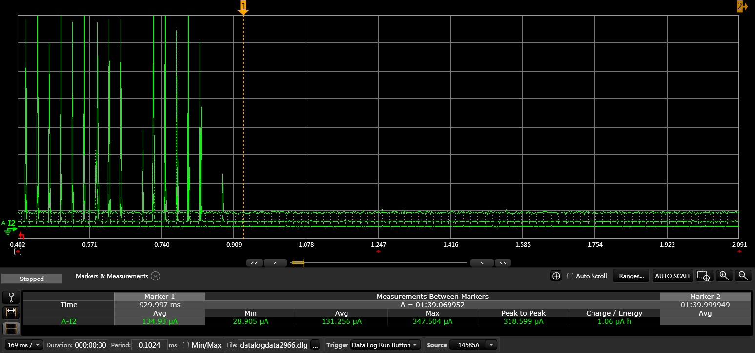

I have measured the power consumption after turning off the ESB(esb_disable();) in the firmware, and the measured average current is about 130uA as follow.

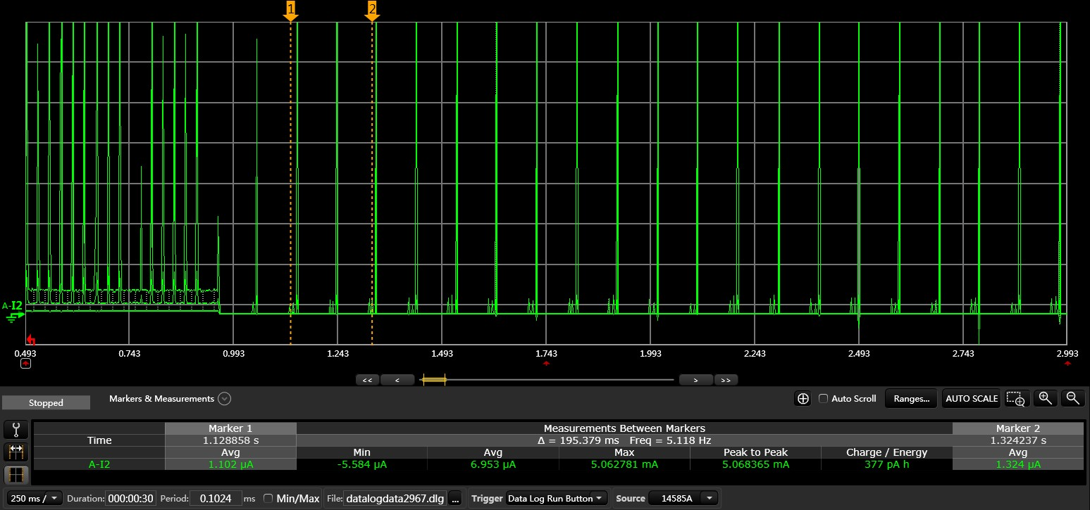

And after I disable esb also and the CLOCK_PLL using NRF_CLOCK->TASKS_PLLSTOP = 1; the measured average current is about 7uA.But there will be a periodic pulse current as follow.
Please provide more detailed trace. Better if you can provide the file or you can measure using PPK2.
What's the interval between the pulse ? What's the peak mA ?
