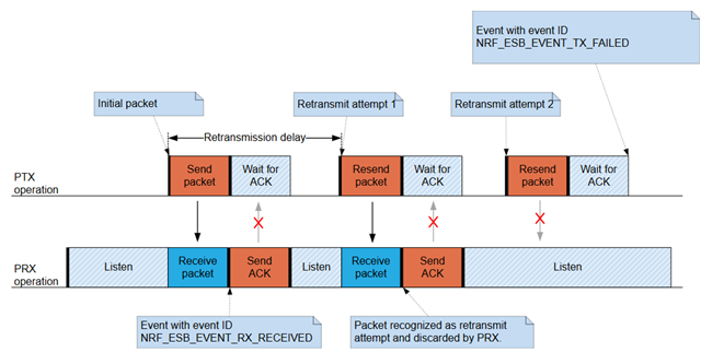

Hi Q&A My keyboard chip is NRF52832, and the program uses ESB 2.4G communication. The receiver dongle uses NRF52833. Now there is a problem that when the CAPSLOCK is clicked with the keyboard, the receiving dog correctly returns the information of CAPSLOCK. When I click CAPSLOCK with another keyboard at the same time, the receiving dongle cannot return information. My understanding is that when ESB, as the sender, sends out a round of data and waits for a while to receive a response type of data, it will close the reception, and if the time exceeds, it cannot receive data. I don't know if my understanding is correct or how I should solve this problem?
    Please correct me if I'm wrong, what you have is one PRX and 2 PTX connect to it act as keyboards. And when you press CAPSLOCK on 2 keyboards at the same time only one get responded ? If you press caplock on only one keyboard, do you see the other keyboard has letter in capital ? What I'm think of here is that the PC only has one CAPSLOCK status, when you turn on the CAPSLOCK on one keyboard, both get enabled (but the CAPSLOCK status LED will not turn on on the other keyboard as it didn't receive the command to turn on the LED).
    Regarding your question about ESB, you can take a look here:
    docs.nordicsemi.com/.../esb_users_guide.html
    If the ACK doesn't come the packet will be retransmitted after a few attempt packet will be marked as missing.

    The ESB seems to experience occasional data loss. Sometimes it can receive the data when a key is pressed, but it fails to receive the data when the key is released. But Bluetooth doesn't have this problem and it works very well.

  • Hi Zbxiong,
    Could you please try reproduce the issue with one of our sample ?
    Do you send with ACK or without ACK ?
    Do you see NRF_ESB_EVENT_TX_FAILED event ?
    It's a nature with radio communication that the packet can be dropped due to collision or other reason. The packet will get retransmitted depends on your configuration, but the chance that a packet be loss is unavoidable with RF communication.
    We need to see the packet drop rate to see if there is actually any problem.

  • Hi Zbxiong,
    1. I don't fully understand what you meant here: ".I can only send the failed returned data to the keyboard to make the indicator light flash." Could you try to explain in more detail ?
    Have you tried to reproduce the issue with our sample ?
    2. As far as I know there is no feature in ESB to do channel survey. It's possible to do channel survey in BLE but it's not implemented in ESB. You will have to think about doing it directly with the radio but then it will break ESB.
    What you can do I think is to implement channel hopping in ESB. It would require the host and the device to keep track of the time and the channel is should jump to. This feature is already implemented in Gazel protocol which is based on top of ESB. This maybe something you can consider. I don't think it would check for channel quality before jumping, it do a scheduled channel hopping but that can reduce the risk of only use one channel all the time.
    But you need to do some calculation to see the rate of packet loss before implementing any measure to improve it.
