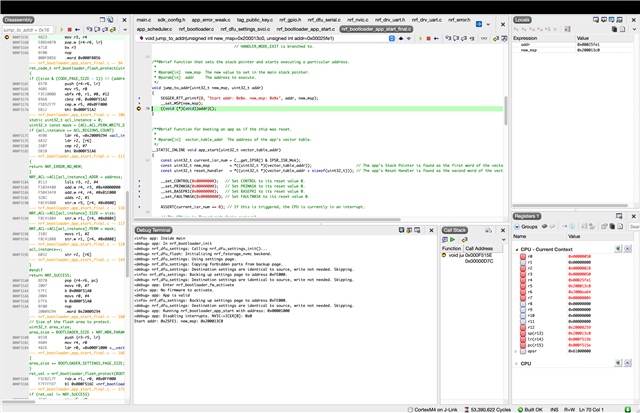

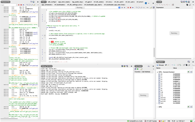

Also, I tried to run app directly from segger after upload app using bootloader (for ble bootloader this works) and I does not enter main at all.
As I understand, the problem is wtih flashplacement or with vector table, and in some reason bootloader try to start app from wrong address, but I can't find the reason and how to fix this
Also, after upload an app, I compare both bootloaders, BLE and serial, how they start an app. Above attached screenshots with breakpoints at the final point of bootloaders.
BLE:
Serial:
