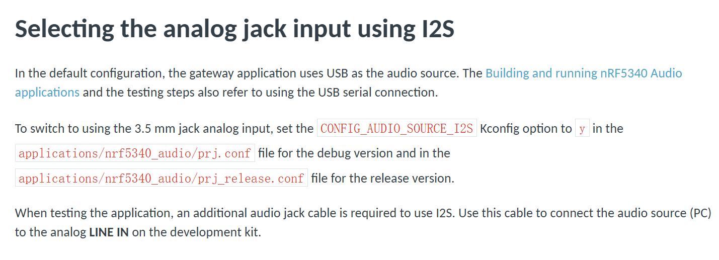

I am using nrf5340 audio dk's BIS mode, connecting gateway device to a PC via USB, it takes audio data from the PC and broadcasts it, I managed to hear the sound on headset device. And now I want to use mobile phone instead of PC to provide audio data to gateway device, what should I do?
