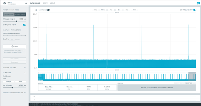

    Using the power-off API on a standalone device, I was able to reach ~5 µA. However, for the Zigbee remote-control use case this is not suitable, because on every wake-up cycle the ZED needs to reconnect and forward the packet.
    I also tested the suggested Zigbee Light Switch sample with sleepy mode enabled. In this SED configuration I am able to achieve around ~500 µA (power profiler image attached). With this value, the battery life is still not sufficient for the remote-control application.
    Could you please confirm whether ~500 µA is the expected baseline for the default ZED/SED example, or should we expect significantly lower consumption?
    Additionally, I am enabling Bluetooth for onboarding, then disabling it before Zigbee starts. This BLE onboarding phase consumes around ~8 mA, but after Zigbee joins successfully the idle current stabilizes at ~500 µA.

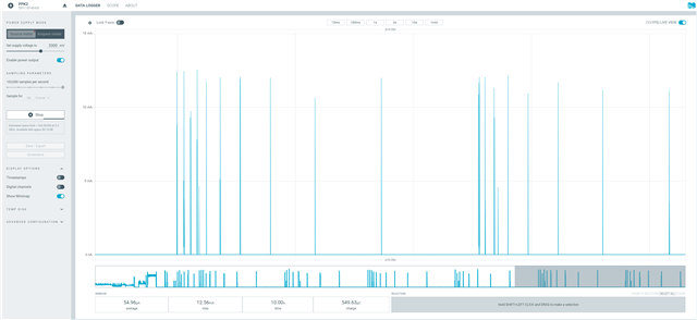

    I am seeing around 55µA using the attached light_switch sample from v2.9.0. I did some modiifications in prj.conf, as disabling logging (and setting the channel to a fixed channel, that I also do in the network coordinator sample, to reduce connection time).
    Additionally, I skipped the button check, and enabled low power mode in main.c. Have a look, and see what current consumption you are seeing.
