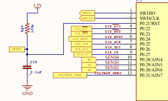

Hi, I am working on long press button interrupt in nrf52832 device & used NCS. I am unable to detect the long press from button.below is my functionality which is I am trying to implement.
press for 10 sec after that call a callback function.

Pin configuration :-
gpio_pin_configure_dt(&button_0, GPIO_INPUT);
gpio_pin_interrupt_configure_dt(&button_0, GPIO_INT_EDGE_BOTH);
configuration in overlay file:-
button0
gpios = <&gpio0 21 GPIO_ACTIVE_LOW>;
label = "SW1";
Suggest a solution how can implement long press button interrupt in zephyr ncs.

  • Thank you. I believe my behavior was a bit different than yours, but we are running this on different hardware, so that may be why.
    In my case, I was not able to trigger the interrupt, because I shorted the pin to a button pin, and your button_0 devicetree configuration didn't have a pullup. So first, I added this in your test.overlay:
        buttons {
            compatible = "gpio-keys";
            button0
                gpios = <&gpio0 21 (GPIO_PULL_UP | GPIO_ACTIVE_LOW)>;
                label = "SW1";
    Then I changed your bsp_button_init() to trigger on both rising and falling edges (like you originally had when you created this ticket):

    And finally, I adjusted your long_button_pressed() callback to check the state of the pin, starting the timer only if it was pressed, and stopping the timer if it was not pressed (which would have been triggered by a release action):

    Also added some logging in that callback, as you can see.
