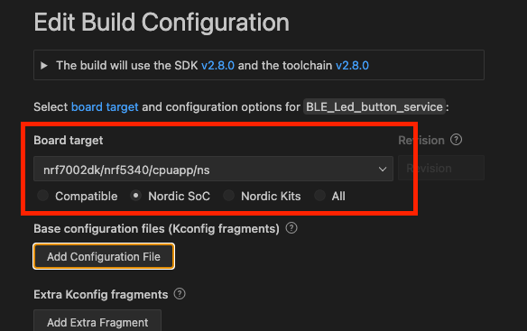

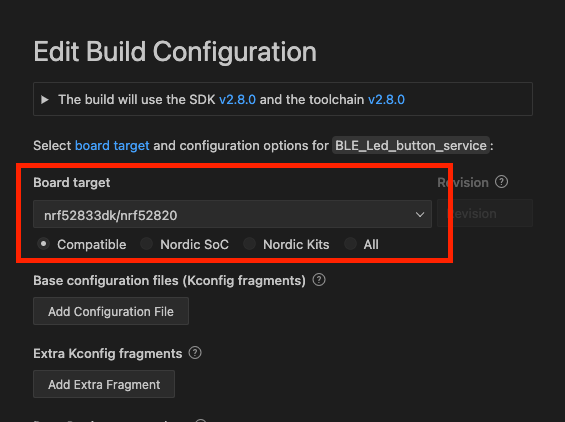

    In the edit build configuration menu the nRF7002-DK is not compatible for most of the BLE sample codes:
    Board target "compatible"
    If I try to force it to build for nRF7002-DK like so:
    Board target "Nordic SoC"
    It compiles but after flashing to device it just not operating as expected from the sample code.

    The "Compatible" term here is unfortunate. That only means that the sample was not deisgned and tested for other boards, but in most cases it will work. And the nRF7002DK has essentially the same features as a nRF5340 DK with the additon of th enRF7002, so most BLE samples will work out of the box.
    DoronC said:
    1. What am I doing wrong ?
    To know that we first need to look at in what way it is not working. Can you elaborate? How do you test, and what do you observe in the logs?
    DoronC said:
    2. Is there any sample code for BLE link between two nRF7002-DKs ?
    There is no BLE samples specifially designed for the nRF7002DK, but as mentionned most (if not all) should work.
