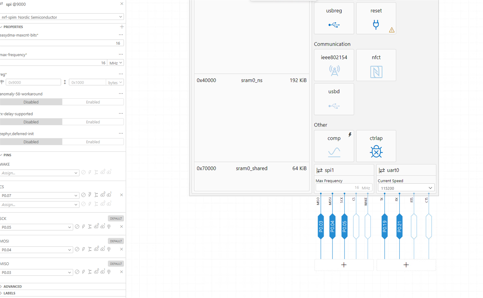

I/ trying to read the ID of a Fijitsu FRAM type MB85RS4MT using the Nordic device nRF5340. I can properly initialize the SPI and transmit the RDID =0x9F command. The FRAM returns, what I think is the proper ID, but it won't show up in software. I'm using the synchronous spi_transceive routine. I Initialize the ID buffer prior use with all 0xFF. The data is overwritten with all zeros ?. This is how the DTC and code looks like. I'm really stuck, can it have something to do with double use of GPIOs ???? within the Device Tree visual editor it appears that NFC is disabled (also using pin P0.03). Could it be that the NFC part it somehow blocking proper use of the pins for SPI. (How can I check?)

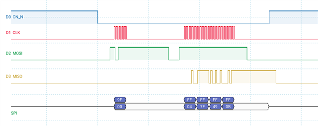

    the tx_buf is 1 byte containing the command. The receive buffer rx_buf  contains the ID memory space of 4 byte + 1 byte for reception during transmission of the RDID command. Same result applies. The complete ID[5] content is zero. I should at least expect some data which is not zero in for index 1..4
    see logic analyzer for the configuration above. Maybe my interpretation of the complete Zephyr SPI concept is wrong but it is very difficult to find proper background information. Especially the tx/rx config part.
