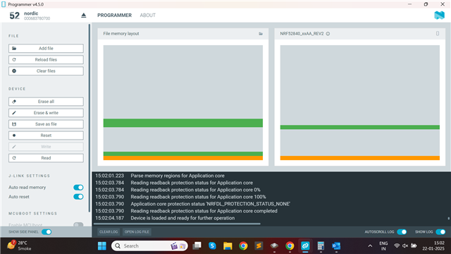

i want to switch between two code... the code is simple led blinking i am trying for the testing purpose...in my code 1 led1 is blinking 500 ms of delay and in my code 2 led2 is blinking 1 sec of delay...i want to archive if i press button on my board then it can able to switch between this two code...where i have put each other flash starting address in code so i can able to start from there if button is pressed...but when i try to flash my code from nrf connect for desktop -> programmer and add the code 1 there there is no problem but when i try to flash code 2 hex file...then it is showing that  some of the HEX file have overlapping data..

    Please make sure that both the codes are built with a separate flash base address. Also, you need a code in the main application to jump to the required code on button press.

    i have not mention in my question. really sorry about that but i am doing with different flash address in my code.. where i am also updating the vector table.. and after doing some experiments now i am able to store in flash but the issue is that if its in application1 when i press the button then it is going into the hardfault in application2. so can you give me solution for that..

  • Could you maybe try resetting the peripherals everytime before you transfer controls between the applications? And also maybe try clearing all existing interrupts that are there before jumping between the applications.
