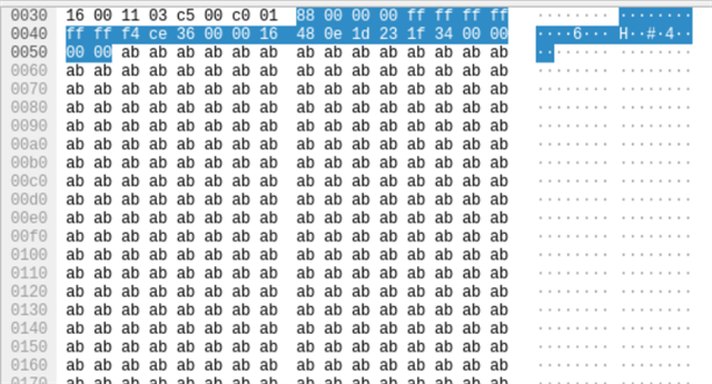

Beyond the modulation scheme and rate, we are interested in what the bit pattern itself is that is being modulated and transmitted. E.g. if we transmit using MCS0, what data pattern is the wifi_radio_test sending? Is it alternating 0s and 1s? Is it a pseudo-random bit sequence, etc.?
Thank you.
Hi Ryan
I got a confirmation from the devs today on this, and we don't use PRBS9. We use Wi-Fi packet with valid mac header with a fixed pattern in payload ( 0xab) in radio test.
Simon
Great, thanks for confirming, Simon!
Could we request a PRBS9 pattern as an option?
Hi Simon, Where is the 0xAB payload located? Are we able to modify it ourselves for experimentation?
