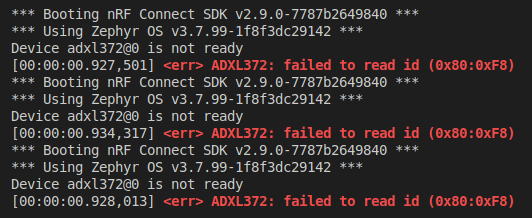

I'm using NCS v2.9.0 and attempting to communicate with an ADXL372 IMU over SPI. Occasionally, the MCU successfully reads from the IMU and begins printing values. However, most of the time it either fails during initialization with a "failed to read device ID" error or stalls while fetching data.

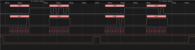

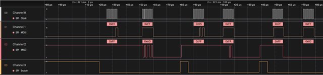

The IMU does correctly send data. Its expected IDs are 0xAD and 0xFA, the logic analyzer output reads 0xAD and 0xFA, but the Zephyr driver errors because the values it reads are 0x80 and 0xF8:

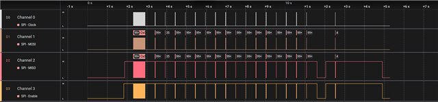

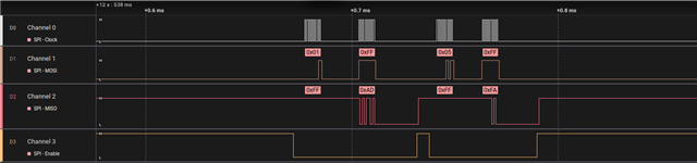

  • I managed to capture a better representation of the problem. Here I am using the nRF54L15-DK, ADXL372, and a Saleae LA. Right before 2s, I set SW4 on the DK to the "ON" position to enable power. The two devices communicate properly until I press the "RESET" button on the DK at around 11.5s. In the same exact conditions, the board no longer reads from the ADXL372 properly.
    Full session:
    Power on:
    After reset:
    Could it be related to this anomaly?

    This turned out to be a problem with the specific IC, at least as far as I can tell. Using a new ADXL372 breakout worked, and works consistently across all builds and DKs now. I'm still not sure why the original only had problems on nRF54L15-DKs but I'm unable to replicate it with another ADXL372 so the problem is more or less solved on my end. Although, I'm happy to provide the firmware anyway if you still want to look into this further. I would just need to remove some of the proprietary details from the code -- let me know.
  • Marcus,
    Thanks for that info, we have seen some sensor boards behave different in such a small way that the edge sensing seems a bit different with our particular soc. In this case the faulty breakout board seem to have wrong polarity at some particular instance which seems to have highlighted on nRF54L15 due to its more accurate clock mechanism. In other variants, this small issue was somehow masked. We do not need to debug this as you said that this happens on one (very few) custom boards. This is not an issue on the nRF side.
