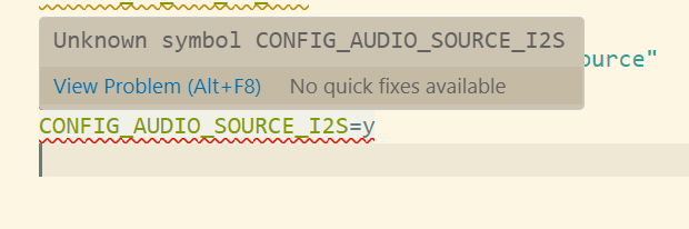

    So, back to the original question: How can I configure both the source and sink to use I2S Line In / Headphone Out?
    According to this documentation  I set CONFIG_AUDIO_SOURCE_I2S (source app), but I see no option with this name, nor is there anything mentioned for the sink app. Also, the LED/Button UI mentioned in the docs doesn't apply so it looks like the docs are inaccurate?

    See nRF5340 Audio configuration: Selecting the analog jack input using I2S and this post.
    Did you add CONFIG_AUDIO_SOURCE_I2S=y to prj.conf file for the debug version /prj_release.conf file for the release version as the instruction? Also, check the .config file under build/Audio to see if it takes effect.

  • I've attached logs for both. The source DK doesn't start streaming until line 1795 when I start playing an audio source and switch the output device to the DK.
    The post you linked to is something different, I don't want to loop back line in > headphone out. I just want my broadcast source DK to stream from Line In, and my broadcast sink DK output to Headphone Out.
    As I wrote above, the source example project doesn't accept CONFIG_AUDIO_SOURCE_I2S=y
    Regarding the UI, there is no UI !! LED1 does not light, none of the switches do anything. I can't see anything in the code to suggest otherwise. Have you actually built & run the code examples using VScode nRF Connect extension "Create new application > copy a sample"?

  • Here is the board
    And here is the toolchain info
    This may well be down to how I am building the app in vscode. I followed the Nordic  walkthrough videos on YouTube, but VScode's UI has changed  since then. This is how I am building the app:
    1. Create New Application
    2. Copy a sample, save
    3. Create new build configuration
    4. Select the correct board target
    5. Use default name "build" and build
    6. Flash
    Adding the line CONFIG_AUDIO_SOURCE_I2S=y to proj.conf results in the "unknown symbol" error.
    I think we are maybe working on different versions of projects. Can you zip up an example and attach it?
  • Add CONFIG_AUDIO_SOURCE_I2S=y to prj.conf file for the debug version /prj_release.conf file for the release version as the instruction in the nRF5340 Audio configuration: Selecting the analog jack input using I2S. The default configuration of the sink should already output to the Headphone Out.
    Let's concentrate on the source for now, as this is what I'm primarily concerned about.
    I can turn USB audio off/on by adding/removing CONFIG_USE_USB_AUDIO_INPUT=y
    If I remove this line I get a test tone broadcast instead.
    But there is still no way I can see to enable I2S? In fact, I performed a text search for "CONFIG_AUDIO_SOURCE_I2S" on the entire project directory, it simply doesn't exist in any file.
    bap_broadcast_source.zip
