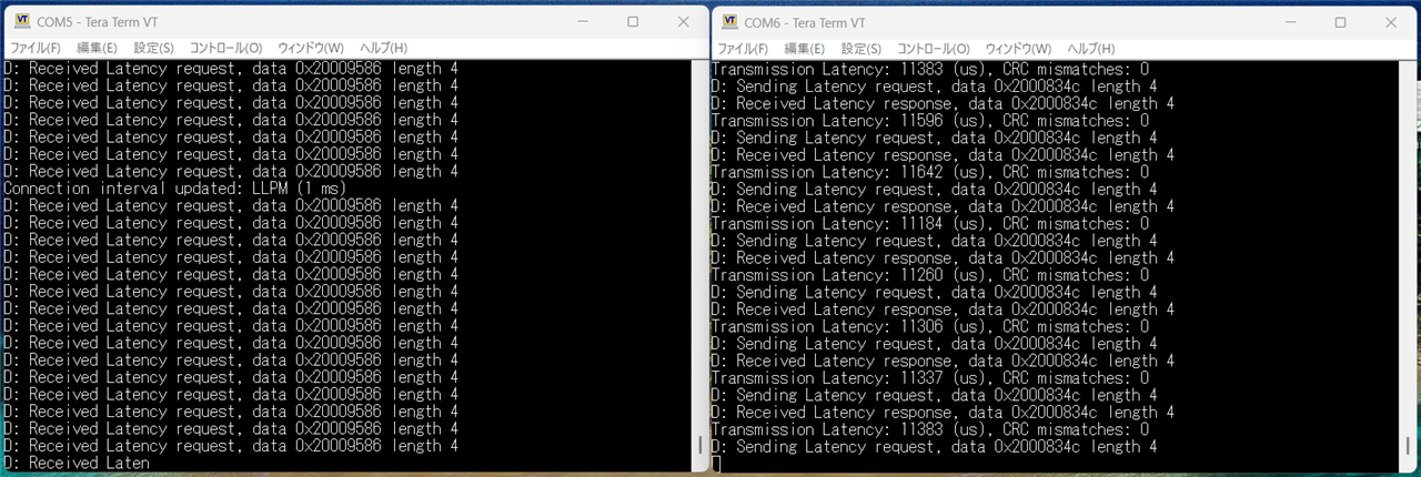

    The numbers displayed in the log are strange because I rewrote the source code, not a bug. And my apologize, I misunderstood the purpose of this sample project. Also I understood that the purpose of this sample project was to measure response times, not to send data.
    I was able to verify that the data is being sent with debug logging enabled. I also understood that it was not displaying the received data (nor setting up callbacks) because this is a project to measure response time.
