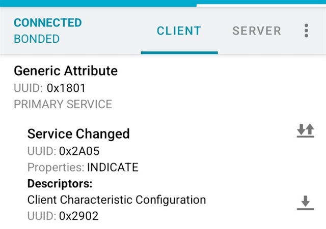

  •  I was doing some more investigation into this issue today and I noticed that our firmware exposes a Service Changed characteristic under the "Generic Attribute" service.
    However, when I try to access that "Generic Attribute" service from inside the app code (see code below), I get null.
    Should the app be able to access this service? I'm wondering if the fact that the app can't access this service is the reason why the app isn't reacting to the Service Changed indications from that characteristic, resulting in the "handle is invalid" error.
