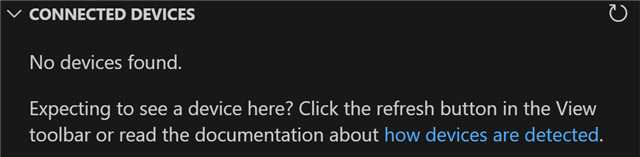

I am attempting to flash firmware onto a custom board with an nRF52832 chip using an nRF52840 DK (v3.0.1) as the debugger and the "nRF Connect" extension on VS Code. However, I am unable to detect the custom board under "connected devices" in VS Code, and the flashing process does not work.

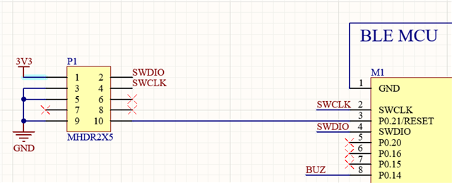

Here is the SWD connector of my target board I want to flash firmware to:
target_board_SWD connector

Here is the setup I used to connect the P19 Debug Out connector on the nRF52840 DK to the SWD connector on the custom board:
Pin Num
nRF52840 DK
P19 Connector
Custom Board
SWD connector
Comments
1
SB19,
SB47
3V3
Custom board has its own power supply(3.3V) and doesn't need DK to provide VDD, so SB47 is not connected
Custom board need to provide the debugger with its voltage reference, so SB19 is connected
2
SWDIO
SWDIO
3
SWD0_SEL
GND
SWD0_SEL need to be set to logic HIGH to enable SWD0 to be used for flashing the custom board, so we cut the cable and connect P19 pin3 to VDD_nRF (P20 pin1)
4
SWDCLK
SEDCLK
5
GND
GND
6
SWO
Not Connected
7
Not Connected
Not Connected
8
Not Connected
Not Connected
9
Not Connected
GND
10
RESET
RESET

Observations
At this point, I expected the custom board serial number to show up under "connected devices" in the VS Code extension, but it did not.
To verify the VS Code setup and the cable connection, I disconnected the cable between the DK and the custom board and switched SW6 to "DEFAULT". In this configuration, the "nRF52840 DK" showed up under "connected devices."

    This is a reference schematic for flashing external board.

    It will be the MCU debugger's serial number you see under "Connected Devices", not the external nRF's serial number no matter which nRF device it's connected to. The SW6 is only to cut off power to anything but the nRF52840 SoC on the DK, so the onboard debugger won't get power if SW6 is set to nRF ONLY. If an external board is connected, the debugger will detect it and automatically program the external board instead of the onboard one, so SW6 should not be necessary to use for your purposes.
    Both connectors P19 and P20 should work just fine.

    Thanks for your help earlier. I resolved the issue with the following adjustments:
    • Set SW6 to Default (ON)
    • Connected SWD0_SEL to GND
    • Selected nRF52832DK (my target board) as the build target
    Settings I kept the same:
    • SB19 remains connected
    • Maintained SWDIO, SWCLK, RESET, and GND connections between the DK and the external board
    To confirm that the interfacing IC on the DK is indeed connected to the external board, I flashed a HelloWorld logging firmware onto the onboard MCU. When powering on the DK alone, I observed my custom message periodically printed to the console. However, when I connected the SWD cable and re-powered the DK, the logging stopped—confirming the interfacing IC is connected to the external board.
    Thanks again for your assistance!
