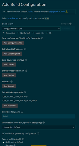

I am attempting to connect to a Wi-Fi network using Exercise 2 from Lesson 2 of the Wi-Fi training in Nordic Academy. However, when I try to connect to the network, I encounter a -134 error while executing the following function:
net_mgmt(NET_REQUEST_WIFI_CONNECT, iface, &cnx_params, sizeof(struct wifi_connect_req_params));
Here's my main.c

my prj.conf :
# # Copyright (c) 2022 Nordic Semiconductor ASA # # SPDX-License-Identifier: LicenseRef-Nordic-5-Clause # # Wi-Fi # STEP 1.1 - Enable the Wi-Fi relevant configurations CONFIG_WIFI=y CONFIG_WIFI_NRF700X=y CONFIG_WPA_SUPP=y # STEP 2 - Configure the Wi-Fi credentials CONFIG_WIFI_CREDENTIALS=y # STEP 12.1 - Diasble static Wi-Fi network configuration CONFIG_WIFI_CREDENTIALS_STATIC=y CONFIG_WIFI_CREDENTIALS_STATIC_SSID="WIFI_NINA" CONFIG_WIFI_CREDENTIALS_STATIC_PASSWORD="TERRAPERAMERA!" # Networking Management API # STEP 1.2 Enable the Network Management relevant configurations CONFIG_NET_MGMT=y CONFIG_NET_MGMT_EVENT=y CONFIG_NET_MGMT_EVENT_INFO=y CONFIG_NET_MGMT_EVENT_STACK_SIZE=16384 CONFIG_NET_CONNECTION_MANAGER=y CONFIG_WIFI_MGMT_EXT=y # STEP 13 Enable support for shell commands # CONFIG_SHELL=y # CONFIG_WIFI_CREDENTIALS_SHELL=y # CONFIG_SHELL_STACK_SIZE=4400 # Logging CONFIG_LOG=y # DK library CONFIG_DK_LIBRARY=y # System settings CONFIG_NEWLIB_LIBC=y CONFIG_NEWLIB_LIBC_NANO=n # Networking CONFIG_NETWORKING=y CONFIG_NET_NATIVE=y CONFIG_NET_SOCKETS=y CONFIG_NET_L2_ETHERNET=y CONFIG_NET_IPV6=n CONFIG_NET_IPV4=y CONFIG_NET_DHCPV4=y CONFIG_NET_BUF_RX_COUNT=16 CONFIG_NET_BUF_TX_COUNT=16 CONFIG_NET_BUF_DATA_SIZE=128 CONFIG_NRF700X_RX_NUM_BUFS=16 CONFIG_NRF700X_MAX_TX_AGGREGATION=4 # nRF700x is main consumer: (16 + 8) * 1600 = ~40KB + ~40KB control path (experimental) CONFIG_NET_TC_TX_COUNT=1 # Memory CONFIG_SYSTEM_WORKQUEUE_STACK_SIZE=4096 CONFIG_MAIN_STACK_SIZE=4096 CONFIG_HEAP_MEM_POOL_SIZE=80000 CONFIG_NET_TX_STACK_SIZE=4096 CONFIG_NET_RX_STACK_SIZE=4096 CONFIG_COMMON_LIBC_MALLOC=y CONFIG_COMMON_LIBC_MALLOC_ARENA_SIZE=30000 CONFIG_WIFI_FIXED_MAC_ADDRESS="04:E8:B9:5C:E0:27"
my .conf of t91x :
# STEP 12.3 - Create a board-specific file for the secure build target CONFIG_WIFI_CREDENTIALS_BACKEND_SETTINGS=y CONFIG_FLASH=y CONFIG_FLASH_PAGE_LAYOUT=y CONFIG_FLASH_MAP=y CONFIG_NVS=y CONFIG_SETTINGS=y CONFIG_SETTINGS_NVS=y
Could you provide guidance or suggest a solution to resolve this issue?
