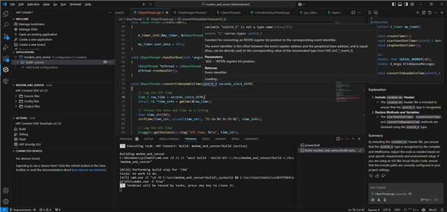

  • Hello Charlie, my project starts from a Nordik sample.
    It is located in C:\ncs, where by default the create new application suggests to put.
    I am working in C++. When edit the program I had a lot of squiggles and AI suggested
    to modify the c_cpp_properties.json. And indeed it works. I add the direct path.
    Now I have moved to 2.9.0, and direct path of compiler and sdk is obviously changed,
    so I decided to put a relative path.
    I modify the settings.json and add
    "nrf-connect.topdir": "c:/ncs"
    "nrf-connect.toolchain": "c:/ncs/toolchains/b620d30767"
    "nrf-connect.sdk": "c:/ncs/v2.9.0"
    and then I modified the c_cpp_properties.json for example
    "compilerPath": "${config:nrf-connect.toolchain}/opt/zephyr-sdk/arm-zephyr-eabi/bin/arm-zephyr-eabi-gcc.exe",
    or
    "includePath": [
    "${workspaceFolder}/**",
    "${config:nrf-connect.sdk}/zephyr/include",
    "${config:nrf-connect.sdk}/zephyr/include/zephyr",
    "${config:nrf-connect.sdk}/nrfxlib"
    Does not work. No reload window, no clear build, no delete build directory
    On one PC seems to work but squiggles the instruction strlen or strcmp.
    On another it does not work at all. Intellisense got crazy. And if i point on uint32_t it jumps me
    to strange declaration!
    I could jump back to absolute path. But this behaviour strongly confuse me.
    Best Regards
  • It works only with absolute path (2.0.9 ), but not for all the instruction. It compiles but intellisense does not work well.
    I go back to 2.7.0
    There everything OK.

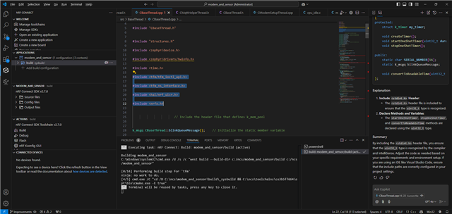

  • It looks like that including this
    #include <tfm/tfm_ioctl_api.h> in a file causes intellisense not to recognize uint32_t anymore.
    I am programming in C++

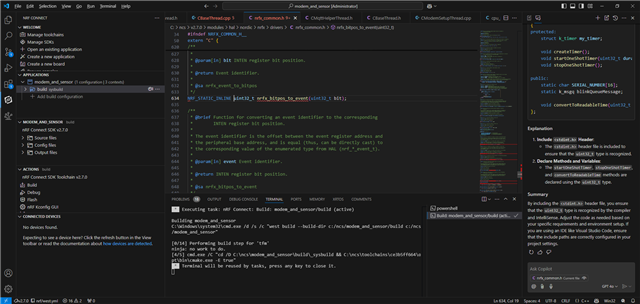

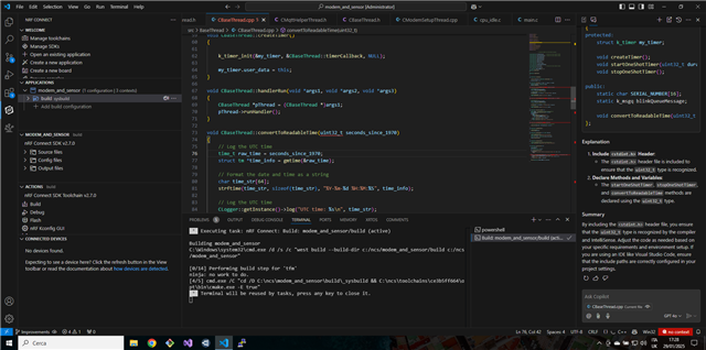

    there are some images of the error and the c_cpp_properties.json.
    In the last image there are highlighted the libraries which drive intellisense crazy))).
    Thanks very much
