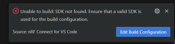

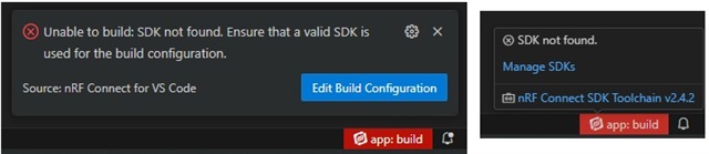

Good morning,
After updating the VSCode extension "nRF Connect SDK" to version v2024.12.55, I encountered an issue where the "Build" and "Action" menus do not update after compilation. The extension repeatedly prompts me to perform a "Pristine Build," even though the code compiles successfully. However, I cannot use any of the additional functionalities. To recompile, I must create a new build configuration and start from scratch each time.
When I click the "Pristine Build" button, an error notification appears: "Unable to find SDK."

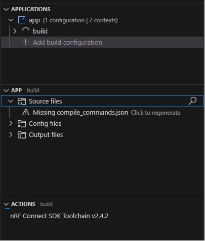

This issue persists even after downgrading to the previous version, v2024.11.75. In this version, clicking "Pristine Build" triggers a new build, but the compilation process reports that the file compile_commands.json is missing. I've checked and this file is present in the build directory, but maybe the extension search for it in the wrong location. Additionally, after compilation, the situation resets, and I must start over by creating a new configuration, as in the last version.
Even reverting further to v2024.9.31 does not resolve the issue, as the "Action" tab does not display any buttons. Versions older than this fail to function entirely.
I have tested various SDK versions (2.9, 2.6.2, 2.4.2), and the behavior remains the same. The installation of the SDK and toolchain proceeds without any issues, so I suspect the extension may be unable to read the build files due to incorrect path handling.

  • Hi Øyvind,
    All SDK versions were installed using the "Manage SDK" option in the VSCode extension. However, I had previously installed the vanilla version manually via the command line a long time ago.
    If I open a new terminal (by clicking "Start New Terminal" next to the build configuration), modify the ZEPHYR_BASE environment variable to C:\ncs\v2.4.2 (removing the path to the vanilla version), and run the west command for the build (after deleting the build directory for a clean build), I encounter the same result. The build logs show that the paths are correctly resolved, so the issue might be specific to the path handling within the "nRF Connect SDK" extension.
    -- Application: C:/Users/prologic/Progetti/contapassi/sw/app
    -- CMake version: 3.20.5
    -- Found Python3: C:/ncs/toolchains/31f4403e35/opt/bin/python.exe (found suitable exact version "3.8.2") found components: Interpreter
    -- Cache files will be written to: C:/ncs/v2.4.2/zephyr/.cache
    -- Zephyr version: 3.3.99 (C:/ncs/v2.4.2/zephyr)
    -- Found west (found suitable version "1.0.0", minimum required is "0.7.1")
    -- Board: contapassaggi
    -- Found host-tools: zephyr 0.16.0 (C:/ncs/toolchains/31f4403e35/opt/zephyr-sdk)
    -- Found toolchain: zephyr 0.16.0 (C:/ncs/toolchains/31f4403e35/opt/zephyr-sdk)
    -- Found Dtc: C:/ncs/toolchains/31f4403e35/opt/bin/dtc.exe (found suitable version "1.4.7", minimum required is "1.4.6")
    -- Found BOARD.dts: C:/Users/prologic/Progetti/contapassi/sw/app/boards/arm/contapassaggi/contapassaggi.dts
    -- Generated zephyr.dts: C:/Users/prologic/Progetti/contapassi/sw/app/build/zephyr/zephyr.dts
    -- Generated devicetree_generated.h: C:/Users/prologic/Progetti/contapassi/sw/app/build/zephyr/include/generated/devicetree_generated.h
    -- Including generated dts.cmake file: C:/Users/prologic/Progetti/contapassi/sw/app/build/zephyr/dts.cmake
    I have deleted the vanilla Zephyr installation from my system, uninstalled and reinstalled the extension, but the ZEPHYR_BASE variable still contains a concatenated path. Where does the "nRF Connect SDK" extension set this variable?
    Thanks
    Simone
