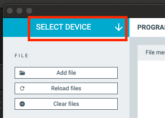

    I am sorry for the delay. Did you m ake any progress on this? I tested the Programmer app with the nrF52840 dongle on macOS 15.2 now, but did not see any issues. Just one thing, could it be that you did not select the device from here?
    When clicked it should look like this, and you need to select the dongle:
    If you do, and Add a file either by clicking "Add file" or dragging and dropping a .hex file, the "Write" button should no longer be grayed out.
