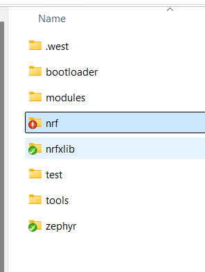

I have a project using ncs 2.7 with the nrf9160. My west manifest file is set up to import all and it takes forever, so I am trying to narrow it down to only what is needed, but when I change the manifest file and run the west init and west update commands, then try to build in the nrf connect vs code extension like I normally do, I get an error that west build is not recognized
What is the right way to add an allow list to limit what is downloaded using west update?
