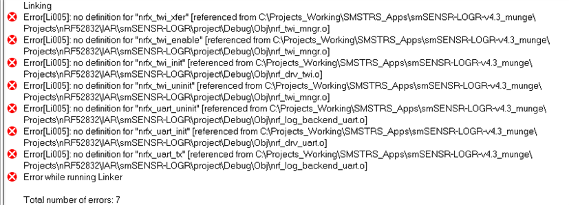

In copying the nRF52810 project to a nRF52832 project I have the project where it compiles but I am running into a few linker errors that are tripping us up along the way to getting this released to the public.  In tracking these errors down and comparing them to the nRF52810 project which has been working fine for some time now it appears these errors are being cause by some additional header files that are getting included in the nRF52832 version that are causing some re-definements of some functions related to the twi and uart functions in particular with the following functions shown below...
More specifically for the UART issues a header file, nrfx_uart.h, is getting pulled into the project and the nrfx_twi.h header files are getting included in the nRF52832 build whereas only the nrf_drv_uart.h and nrf_drv_tw.h are getting pulled into the nRF52810 project and the nrfx header files are what are causing the issues.  I have tried various configurations in the sdk_config.h files and have had no success resolving these issue.  Hoping you can lend some insight as to how to resolve these issues.

     Yes I have confirmed all paths to both source and header files are valid that was one of the first things I did ;-)  The clue comes from there are additional nrfx header files in the nRF52832 project that are getting pulled in that are NOT being pulled in on the nRF52810 project.  These 2 files are nrfx_twi.h and nrfx_uart.h along with the nrf_drv_twi.h and nrf_drv_uart.h files which are changing the way various functions related to the twi and uart peripherals are defined/compiled.
    As an example if we take one of the uart errors such as the "no definition for "nrfx_uart_init" in nrf_drv_uart.c or more specifically the object file being nrf_drv_uart.o as shown below.
    Error[Li005]: no definition for "nrfx_uart_init" [referenced from C:\Projects_Working\SMSTRS_Apps\smSENSR-LOGR-v4.3_munge\
    Projects\nRF52832\IAR\smSENSR-LOGR\project\Debug\Obj\nrf_drv_uart.o]
    nrfx_uart_init() => is referenced in the nrf_drv_uart.h file via a #define and is set to 0.  The nrfx_uart.h(NOT being pulled into the nRF52810 build) file is also pulled into the build in the nrf_drv_uart.h file due to the compiler optoin 'NRF_DRV_WITH_UART' which gets defined earlier in this header file due to statement shown just below...
    #if defined(UART_PRESENT) && NRFX_CHECK(NRFX_UART_ENABLED)
    #define NRF_DRV_UART_WITH_UART
    The compiler Option 'UART_PRESENT' is set in the nRF52832_peripherals.h for which this header file does NOT exist in the nRF52810 build and in fact if I search the entire nRF52810 project I don't find any #define for the UART_PRESENT?
    IF I comment out the 2 lines in the nRF52832_peripherals.h file the link errors go away which is good BUT I am not understanding what the correlative file for the nRF52810 would be?  I.E. - Shouldn't these same #defines shown below also be defined in say a nRF52810_peripherals.h file?

    For the nrfx_twi_xfer, nrfx_twi_enable, nrfx_twi_init, and nrfx_twi_uninit "no definition" issues I was also able to resolve this by commenting out the following lines in the nRF52832_peripherals.h file...
    /* Two Wire Interface Master */
    //#define TWI_PRESENT
    //#define TWI_COUNT 2
    Still unclear as to why there are not similar defines in the nRF52810 build with a similar header file like nRF52810_peripherals.h ?
    So now I am down to one last error where the 'SPIM0_SPIS0_TWIM0_TWIS0_SPI0_TWI0_IRQHandler' is being defined in 2 different locations once in nrfx_spim.o and the second in the nrfx_twim.o compiled files.  Doing a complete project search appears this can be defined in both the nRF51_to_nRF52.h file and then also in the nrfx_irqs_nrf52832.h header files...any ideas which file should take precedence for the definition for SPIM0_SPIS0_TWIM0_TWIS0_SPI0_TWI0_IRQHandler

  • TWIM0 and SPIM0 use different instances on the nRF52810 compared with the same instance on the nRF52832, so must change (say) SPIM0 to SPIM1 to use physically different peripheral (ie. can't use both TWIM0 and SPIM0 on nRF52832)

  • Yes re-assigning the TWIM0 to TWIM1 resolved the last compile/link issue.  Project now builds/compiles.
