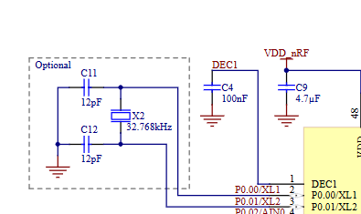

We are encountering an issue where the existing firmware does not run on the chip when powered by a coin cell, even though a 3.3V power supply is available from the coin cell. The firmware application only starts running after performing a software reset using nRF Connect while the power supply is connected via J-Link. How can this issue be resolved on the firmware side without adding a hardware reset switch?

    We are using a custom board based on the nRF52 MCU, where P0.21 (Reset) is left unconnected. That’s why I asked if any changes are required on the firmware side to ensure the application runs on the MCU using a coin cell after it has been programmed. Will the code run automatically once the MCU is powered up?

    One thing I need to mention that blinky sample typically uses the external crystal 32.768kHz connected to P0.00 and P0.01 as the default LFCLK source.
    The system waits until the crystal starts counting.
    Do you have external crystal? if not you can use the internal RC oscillator for the LFCLK by setting CONFIG_CLOCK_CONTROL_NRF_K32SRC_RC=y in prj.conf file.
