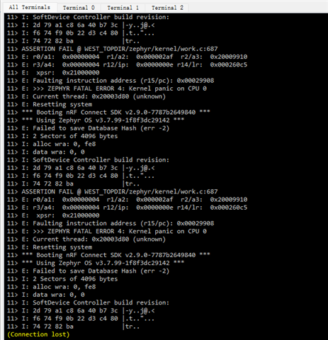

settints_load() make sys resetting repeatly
Hello,I program with nrf52833,NCS v2.9.0.And there is an error happened.
In my main() ,if I place settings_load() at top, it will make my sys resetting.
Cause I need to load param at the first of the sys ready,so placing settings_load() at top.
Can u help to sovle this err?Or do there any other way to store params into flash?Such as flash_write、flash_read and so on?
Best regards.

	NRF_POWER->DCDCEN=0; // DCDC disable
	if (IS_ENABLED(CONFIG_SETTINGS)) {     //If place settings_load() here,some err happened.
		settings_load();

    if (IS_ENABLED(CONFIG_SETTINGS)) {     //If place settings_load() here,everyting fine
		settings_load();
