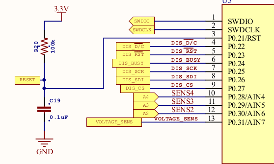

Hi, I am using a custom nrf52832 device. In that device , button is connected with reset pin P0.21. due to reset functionality I am not able get interrupt from button.
how can I use P0.21 as normal gpio??
Can I implement long-press functionality on P0.21 pin??
below is schematic of button and reset pin.

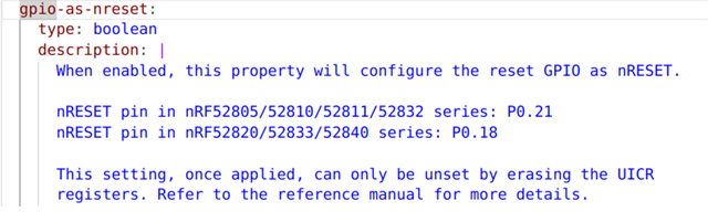

I have tried below possibilities
- used longpress node.
- disabled uicr node from dts.
- Remove GPIO as nRESET properties.
according to the documentation of nRESET.
while in nrf5 sdk it is working as gpio. why not in nrf connect sdk??

    Yes, it should be fine setting it up like this. You need to use the /delete-property/ if the gpio-as-nreset is set by default I believe. But why are you enabling the Softreset when flashing after doing so? The pin shouldn't be needed to do a full reset when flashing? Have you tried power cycling the board and see if it works afterwards when you've flashed it like this? A full power cycle might be needed after flashing the device when using softreset.
    What exactly are you using the reset pin GPIO for in your project?
