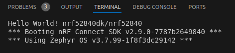

nrf connect sdk v2.9.0 logs not printing
sample example zephyr/samples/hello_world  build & flash successfully  in nrf connect sdk v2.9.0 but logs not printing using UART & RTT

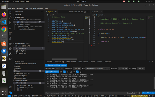

same code zephyr/samples/hello_world  build & flash successfully in nrf connect sdk v2.7.0.     logs also print using UART & RTT
following image showing prj.config  file with code
Q) how i can print logs in nrf connect sdk v2.9.0 ?
Q) Any other suggestions for v2.9.0 ?
    Are you able to get logs if prj.conf is empty? Have you tried using a different terminal emulator, such as the one in the nRF Connect for Visual Studio Code extension or the Serial Terminal app?
    I tried to reproduce the issue, but I got logs with the Hello World sample in v2.9.0. The only difference I saw when using the Kconfig options in your screenshot was that the "hello world" line was printed before the nRF Connect SDK and Zephyr banners instead of after.

    with empty prj.conf no logs printing. i tried serial terminal app but for nrf connect sdk v2.9.0 no logs printing in serial terminal but for v2.7.0 logs printing.
    in prj.conf file which configuration you include.
    I tried both with an empty prj.conf and with the following:
    CONFIG_LOG=y
    CONFIG_UART_CONSOLE=y
    CONFIG_LOG_BACKEND_UART=y
    CONFIG_LOG_PRINTK=y
    CONFIG_GPIO=y
    CONFIG_USE_SEGGER_RTT=n
    CONFIG_LOG_BACKEND_RTT=n
    CONFIG_LOG_BUFFER_SIZE=2948

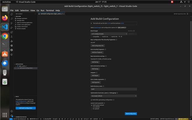

  • im using custom board nrf21540dk   i.e., while building code selectes device is nrf21540dk/nrf52840.

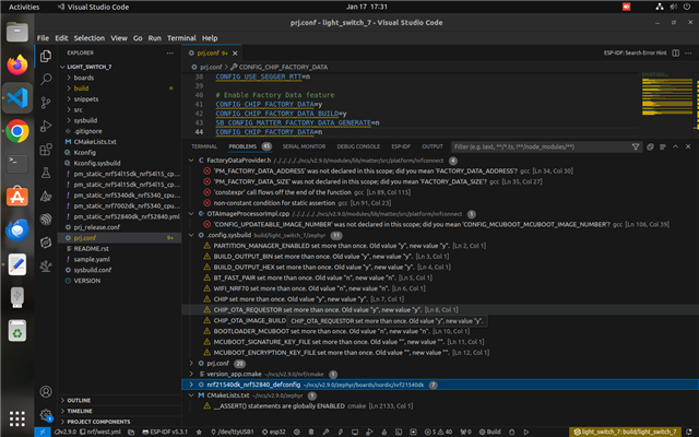

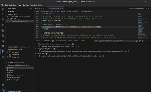

    i tried matter sample light switch code that code also showing like -
    above is the build configuration of matter light switch sample code
     Executing task: nRF Connect: Generate config nrf21540dk/nrf52840 for /home/nistantritech/light_switch_7
    Building light_switch_7
    west build --build-dir /home/nistantritech/light_switch_7/build /home/nistantritech/light_switch_7 --pristine --board nrf21540dk/nrf52840 -- -DNCS_TOOLCHAIN_VERSION=NONE -DCONF_FILE=/home/nistantritech/light_switch_7/prj.conf -DDTC_OVERLAY_FILE=boards/nrf21540dk_nrf52840.overlay -DBOARD_ROOT=/home/nistantritech/light_switch_7

    warning: Deprecated symbol NET_SOCKETS_POSIX_NAMES is enabled.

    [201/518] c++ obj/src/platform/nrfconnect/nrfconnect.OTAImageProcessorImpl.cpp.o
    FAILED: obj/src/platform/nrfconnect/nrfconnect.OTAImageProcessorImpl.cpp.o
    ccache /home/nistantritech/ncs/toolchains/b77d8c1312/opt/zephyr-sdk/arm-zephyr-eabi/bin/arm-zephyr-eabi-g++ -MMD -MF obj/src/platform/nrfconnect/nrfconnect.OTAImageProcessorImpl.cpp.o.d -Wconversion -mthumb -Os -g2 -fno-common -ffunction-sections -fdata-sections -fno-exceptions -fno-unwind-tables -fno-asynchronous-unwind-tables -Wall -Werror -Wstack-usage=8192 -Wextra -Wshadow -Wunreachable-code -Wvla -Wformat -Wformat-nonliteral -Wformat-security -Wundef -Wno-deprecated-declarations -Wno-missing-field-initializers -Wno-unknown-warning-option -Wno-unused-parameter -Wno-unused -Wno-cast-function-type -Wno-psabi -Wno-maybe-uninitialized -Wno-builtin-macro-redefined -fdiagnostics-color -fno-strict-aliasing -D_POSIX_C_SOURCE=200809 -DMBEDTLS_PSA_CRYPTO_USER_CONFIG_FILE=\<nrf-psa-crypto-user-config.h\> -DMBEDTLS_CONFIG_FILE=\<nrf-config.h\> -DMBEDTLS_PSA_CRYPTO_CONFIG_FILE=\<nrf-psa-crypto-config.h\> -fmacro-prefix-map=../../../../../ncs/v2.9.0/modules/lib/matter/= -std=gnu++17 -fno-rtti -Wnon-virtual-dtor -isystem/home/nistantritech/ncs/v2.9.0/nrf/drivers/mpsl/clock_control -isystem/home/nistantritech/light_switch_7/build/light_switch_7/zephyr/include/generated/zephyr -isystem/home/nistantritech/ncs/v2.9.0/zephyr/include -isystem/home/nistantritech/light_switch_7/build/light_switch_7/zephyr/include/generated -isystem/home/nistantritech/ncs/v2.9.0/zephyr/soc/nordic -isystem/home/nistantritech/ncs/v2.9.0/zephyr/lib/libc/newlib/include -isystem/home/nistantritech/ncs/v2.9.0/zephyr/lib/libc/common/include -isystem/home/nistantritech/ncs/v2.9.0/zephyr/soc/nordic/nrf52/. -isystem/home/nistantritech/ncs/v2.9.0/zephyr/soc/nordic/common/. -isystem/home/nistantritech/ncs/v2.9.0/zephyr/subsys/bluetooth -isystem/home/nistantritech/ncs/v2.9.0/zephyr/subsys/settings/include -isystem/home/nistantritech/ncs/v2.9.0/nrf/include -isystem/home/nistantritech/ncs/v2.9.0/nrf/lib/multithreading_lock/. -isystem/home/nistantritech/ncs/v2.9.0/nrf/subsys/bluetooth/controller/. -isystem/home/nistantritech/ncs/v2.9.0/nrf/subsys/trusted_storage/include -isystem/home/nistantritech/ncs/v2.9.0/zephyr/drivers/flash -isystem/home/nistantritech/ncs/v2.9.0/nrf/tests/include -isystem/home/nistantritech/ncs/v2.9.0/zephyr/modules/openthread/platform/. -isystem/home/nistantritech/ncs/v2.9.0/modules/hal/cmsis/CMSIS/Core/Include -isystem/home/nistantritech/ncs/v2.9.0/zephyr/modules/cmsis/. -isystem/home/nistantritech/ncs/v2.9.0/modules/hal/nordic/nrfx -isystem/home/nistantritech/ncs/v2.9.0/modules/hal/nordic/nrfx/drivers/include -isystem/home/nistantritech/ncs/v2.9.0/modules/hal/nordic/nrfx/mdk -isystem/home/nistantritech/ncs/v2.9.0/zephyr/modules/hal_nordic/nrfx/. -isystem/home/nistantritech/ncs/v2.9.0/modules/lib/zcbor/include -isystem/home/nistantritech/ncs/v2.9.0/nrfxlib/nfc/include -isystem/home/nistantritech/ncs/v2.9.0/nrfxlib/softdevice_controller/include -isystem/home/nistantritech/ncs/v2.9.0/nrfxlib/mpsl/fem/common/include -isystem/home/nistantritech/ncs/v2.9.0/nrfxlib/mpsl/fem/nrf21540_gpio/include -isystem/home/nistantritech/ncs/v2.9.0/nrfxlib/mpsl/fem/nrf21540_gpio_spi/include -isystem/home/nistantritech/ncs/v2.9.0/nrfxlib/mpsl/fem/nrf2220/include -isystem/home/nistantritech/ncs/v2.9.0/nrfxlib/mpsl/fem/nrf2240/include -isystem/home/nistantritech/ncs/v2.9.0/nrfxlib/mpsl/fem/nrf22xx/include -isystem/home/nistantritech/ncs/v2.9.0/nrfxlib/mpsl/fem/simple_gpio/include -isystem/home/nistantritech/ncs/v2.9.0/nrfxlib/mpsl/fem/include -isystem/home/nistantritech/ncs/v2.9.0/nrfxlib/mpsl/fem/include/protocol -isystem/home/nistantritech/ncs/v2.9.0/nrfxlib/mpsl/include -isystem/home/nistantritech/ncs/v2.9.0/nrfxlib/mpsl/include/protocol -isystem/home/nistantritech/ncs/v2.9.0/nrfxlib/openthread/include -isystem/home/nistantritech/ncs/v2.9.0/nrfxlib/crypto/nrf_cc310_platform/include -isystem/home/nistantritech/ncs/v2.9.0/nrfxlib/crypto/nrf_oberon/include -isystem/home/nistantritech/ncs/v2.9.0/nrfxlib/crypto/nrf_oberon/include/mbedtls -isystem/home/nistantritech/light_switch_7/build/light_switch_7/generated/library_nrf_security_psa -isystem/home/nistantritech/ncs/v2.9.0/nrf/subsys/nrf_security/include -isystem/home/nistantritech/ncs/v2.9.0/nrf/subsys/nrf_security/src/threading/include -isystem/home/nistantritech/ncs/v2.9.0/nrf/subsys/nrf_security/src/utils -isystem/home/nistantritech/ncs/v2.9.0/modules/crypto/oberon-psa-crypto/oberon/drivers -isystem/home/nistantritech/ncs/v2.9.0/modules/crypto/oberon-psa-crypto/include -isystem/home/nistantritech/ncs/v2.9.0/modules/crypto/oberon-psa-crypto/library -isystem/home/nistantritech/ncs/v2.9.0/modules/crypto/mbedtls/library -isystem/home/nistantritech/ncs/v2.9.0/modules/crypto/mbedtls/include -isystem/home/nistantritech/ncs/v2.9.0/modules/crypto/mbedtls/include/library -isystem/home/nistantritech/ncs/v2.9.0/nrfxlib/nrf_802154/driver/include -isystem/home/nistantritech/ncs/v2.9.0/nrfxlib/nrf_802154/sl/include -isystem/home/nistantritech/ncs/v2.9.0/nrfxlib/nrf_802154/sl/sl/include -isystem/home/nistantritech/ncs/v2.9.0/nrfxlib/nrf_802154/common/include -isystem/home/nistantritech/ncs/v2.9.0/zephyr/modules/hal_nordic/nrf_802154/include -DKERNEL -D__ZEPHYR__=1 -D_ANSI_SOURCE -D__LINUX_ERRNO_EXTENSIONS__ -DUSE_PARTITION_MANAGER=1 -D__PROGRAM_START -DNRF52840_XXAA -DZCBOR_CANONICAL -DZCBOR_ASSERTS -D__FILE__=__FILE_NAME__ -fno-strict-aliasing -fcheck-new -std=c++17 -fno-exceptions -fno-rtti -imacros/home/nistantritech/light_switch_7/build/light_switch_7/zephyr/include/generated/zephyr/autoconf.h -gdwarf-4 -fdiagnostics-color=always -mcpu=cortex-m4 -mthumb -mabi=aapcs -mfp16-format=ieee --sysroot=/home/nistantritech/ncs/toolchains/b77d8c1312/opt/zephyr-sdk/arm-zephyr-eabi/arm-zephyr-eabi -imacros/home/nistantritech/ncs/v2.9.0/zephyr/include/zephyr/toolchain/zephyr_stdint.h -fno-pic -fno-pie --param=min-pagesize=0 -fmacro-prefix-map=/home/nistantritech/light_switch_7=CMAKE_SOURCE_DIR -fmacro-prefix-map=/home/nistantritech/ncs/v2.9.0/zephyr=ZEPHYR_BASE -fmacro-prefix-map=/home/nistantritech/ncs/v2.9.0=WEST_TOPDIR -specs=nano.specs -D_POSIX_THREADS -std=gnu++17 -DNDEBUG -DCHIP_HAVE_CONFIG_H=1 -I../../../../../ncs/v2.9.0/modules/lib/matter/src/include -I../../../../../ncs/v2.9.0/modules/lib/matter/src -Igen/include -I../../../../../ncs/v2.9.0/modules/lib/matter/third_party/nlassert/repo/include -I../../../../../ncs/v2.9.0/modules/lib/matter/third_party/nlio/repo/include -I../../../../../ncs/v2.9.0/modules/lib/matter/zzz_generated/app-common -c ../../../../../ncs/v2.9.0/modules/lib/matter/src/platform/nrfconnect/OTAImageProcessorImpl.cpp -o obj/src/platform/nrfconnect/nrfconnect.OTAImageProcessorImpl.cpp.o
    ../../../../../ncs/v2.9.0/modules/lib/matter/src/platform/nrfconnect/OTAImageProcessorImpl.cpp: In member function 'CHIP_ERROR chip::DeviceLayer::OTAImageProcessorImpl::PrepareDownloadImpl()':
    ../../../../../ncs/v2.9.0/modules/lib/matter/src/platform/nrfconnect/OTAImageProcessorImpl.cpp:106:39: error: 'CONFIG_UPDATEABLE_IMAGE_NUMBER' was not declared in this scope; did you mean 'CONFIG_MCUBOOT_MCUBOOT_IMAGE_NUMBER'?
      106 |     for (int image_id = 0; image_id < CONFIG_UPDATEABLE_IMAGE_NUMBER; ++image_id)
    ../../../../../ncs/v2.9.0/modules/lib/matter/src/platform/nrfconnect/OTAImageProcessorImpl.cpp:106:39: note: maximum limit of 1000 namespaces searched for 'CONFIG_UPDATEABLE_IMAGE_NUMBER'
    At global scope:
    cc1plus: note: unrecognized command-line option '-Wno-unknown-warning-option' may have been intended to silence earlier diagnostics
    [202/518] c++ obj/src/platform/nrfconnect/nrfconnect.FactoryDataProvider.cpp.o
    FAILED: obj/src/platform/nrfconnect/nrfconnect.FactoryDataProvider.cpp.o
    ccache /home/nistantritech/ncs/toolchains/b77d8c1312/opt/zephyr-sdk/arm-zephyr-eabi/bin/arm-zephyr-eabi-g++ -MMD -MF obj/src/platform/nrfconnect/nrfconnect.FactoryDataProvider.cpp.o.d -Wconversion -mthumb -Os -g2 -fno-common -ffunction-sections -fdata-sections -fno-exceptions -fno-unwind-tables -fno-asynchronous-unwind-tables -Wall -Werror -Wstack-usage=8192 -Wextra -Wshadow -Wunreachable-code -Wvla -Wformat -Wformat-nonliteral -Wformat-security -Wundef -Wno-deprecated-declarations -Wno-missing-field-initializers -Wno-unknown-warning-option -Wno-unused-parameter -Wno-unused -Wno-cast-function-type -Wno-psabi -Wno-maybe-uninitialized -Wno-builtin-macro-redefined -fdiagnostics-color -fno-strict-aliasing -D_POSIX_C_SOURCE=200809 -DMBEDTLS_PSA_CRYPTO_USER_CONFIG_FILE=\<nrf-psa-crypto-user-config.h\> -DMBEDTLS_CONFIG_FILE=\<nrf-config.h\> -DMBEDTLS_PSA_CRYPTO_CONFIG_FILE=\<nrf-psa-crypto-config.h\> -fmacro-prefix-map=../../../../../ncs/v2.9.0/modules/lib/matter/= -std=gnu++17 -fno-rtti -Wnon-virtual-dtor -isystem/home/nistantritech/ncs/v2.9.0/nrf/drivers/mpsl/clock_control -isystem/home/nistantritech/light_switch_7/build/light_switch_7/zephyr/include/generated/zephyr -isystem/home/nistantritech/ncs/v2.9.0/zephyr/include -isystem/home/nistantritech/light_switch_7/build/light_switch_7/zephyr/include/generated -isystem/home/nistantritech/ncs/v2.9.0/zephyr/soc/nordic -isystem/home/nistantritech/ncs/v2.9.0/zephyr/lib/libc/newlib/include -isystem/home/nistantritech/ncs/v2.9.0/zephyr/lib/libc/common/include -isystem/home/nistantritech/ncs/v2.9.0/zephyr/soc/nordic/nrf52/. -isystem/home/nistantritech/ncs/v2.9.0/zephyr/soc/nordic/common/. -isystem/home/nistantritech/ncs/v2.9.0/zephyr/subsys/bluetooth -isystem/home/nistantritech/ncs/v2.9.0/zephyr/subsys/settings/include -isystem/home/nistantritech/ncs/v2.9.0/nrf/include -isystem/home/nistantritech/ncs/v2.9.0/nrf/lib/multithreading_lock/. -isystem/home/nistantritech/ncs/v2.9.0/nrf/subsys/bluetooth/controller/. -isystem/home/nistantritech/ncs/v2.9.0/nrf/subsys/trusted_storage/include -isystem/home/nistantritech/ncs/v2.9.0/zephyr/drivers/flash -isystem/home/nistantritech/ncs/v2.9.0/nrf/tests/include -isystem/home/nistantritech/ncs/v2.9.0/zephyr/modules/openthread/platform/. -isystem/home/nistantritech/ncs/v2.9.0/modules/hal/cmsis/CMSIS/Core/Include -isystem/home/nistantritech/ncs/v2.9.0/zephyr/modules/cmsis/. -isystem/home/nistantritech/ncs/v2.9.0/modules/hal/nordic/nrfx -isystem/home/nistantritech/ncs/v2.9.0/modules/hal/nordic/nrfx/drivers/include -isystem/home/nistantritech/ncs/v2.9.0/modules/hal/nordic/nrfx/mdk -isystem/home/nistantritech/ncs/v2.9.0/zephyr/modules/hal_nordic/nrfx/. -isystem/home/nistantritech/ncs/v2.9.0/modules/lib/zcbor/include -isystem/home/nistantritech/ncs/v2.9.0/nrfxlib/nfc/include -isystem/home/nistantritech/ncs/v2.9.0/nrfxlib/softdevice_controller/include -isystem/home/nistantritech/ncs/v2.9.0/nrfxlib/mpsl/fem/common/include -isystem/home/nistantritech/ncs/v2.9.0/nrfxlib/mpsl/fem/nrf21540_gpio/include -isystem/home/nistantritech/ncs/v2.9.0/nrfxlib/mpsl/fem/nrf21540_gpio_spi/include -isystem/home/nistantritech/ncs/v2.9.0/nrfxlib/mpsl/fem/nrf2220/include -isystem/home/nistantritech/ncs/v2.9.0/nrfxlib/mpsl/fem/nrf2240/include -isystem/home/nistantritech/ncs/v2.9.0/nrfxlib/mpsl/fem/nrf22xx/include -isystem/home/nistantritech/ncs/v2.9.0/nrfxlib/mpsl/fem/simple_gpio/include -isystem/home/nistantritech/ncs/v2.9.0/nrfxlib/mpsl/fem/include -isystem/home/nistantritech/ncs/v2.9.0/nrfxlib/mpsl/fem/include/protocol -isystem/home/nistantritech/ncs/v2.9.0/nrfxlib/mpsl/include -isystem/home/nistantritech/ncs/v2.9.0/nrfxlib/mpsl/include/protocol -isystem/home/nistantritech/ncs/v2.9.0/nrfxlib/openthread/include -isystem/home/nistantritech/ncs/v2.9.0/nrfxlib/crypto/nrf_cc310_platform/include -isystem/home/nistantritech/ncs/v2.9.0/nrfxlib/crypto/nrf_oberon/include -isystem/home/nistantritech/ncs/v2.9.0/nrfxlib/crypto/nrf_oberon/include/mbedtls -isystem/home/nistantritech/light_switch_7/build/light_switch_7/generated/library_nrf_security_psa -isystem/home/nistantritech/ncs/v2.9.0/nrf/subsys/nrf_security/include -isystem/home/nistantritech/ncs/v2.9.0/nrf/subsys/nrf_security/src/threading/include -isystem/home/nistantritech/ncs/v2.9.0/nrf/subsys/nrf_security/src/utils -isystem/home/nistantritech/ncs/v2.9.0/modules/crypto/oberon-psa-crypto/oberon/drivers -isystem/home/nistantritech/ncs/v2.9.0/modules/crypto/oberon-psa-crypto/include -isystem/home/nistantritech/ncs/v2.9.0/modules/crypto/oberon-psa-crypto/library -isystem/home/nistantritech/ncs/v2.9.0/modules/crypto/mbedtls/library -isystem/home/nistantritech/ncs/v2.9.0/modules/crypto/mbedtls/include -isystem/home/nistantritech/ncs/v2.9.0/modules/crypto/mbedtls/include/library -isystem/home/nistantritech/ncs/v2.9.0/nrfxlib/nrf_802154/driver/include -isystem/home/nistantritech/ncs/v2.9.0/nrfxlib/nrf_802154/sl/include -isystem/home/nistantritech/ncs/v2.9.0/nrfxlib/nrf_802154/sl/sl/include -isystem/home/nistantritech/ncs/v2.9.0/nrfxlib/nrf_802154/common/include -isystem/home/nistantritech/ncs/v2.9.0/zephyr/modules/hal_nordic/nrf_802154/include -DKERNEL -D__ZEPHYR__=1 -D_ANSI_SOURCE -D__LINUX_ERRNO_EXTENSIONS__ -DUSE_PARTITION_MANAGER=1 -D__PROGRAM_START -DNRF52840_XXAA -DZCBOR_CANONICAL -DZCBOR_ASSERTS -D__FILE__=__FILE_NAME__ -fno-strict-aliasing -fcheck-new -std=c++17 -fno-exceptions -fno-rtti -imacros/home/nistantritech/light_switch_7/build/light_switch_7/zephyr/include/generated/zephyr/autoconf.h -gdwarf-4 -fdiagnostics-color=always -mcpu=cortex-m4 -mthumb -mabi=aapcs -mfp16-format=ieee --sysroot=/home/nistantritech/ncs/toolchains/b77d8c1312/opt/zephyr-sdk/arm-zephyr-eabi/arm-zephyr-eabi -imacros/home/nistantritech/ncs/v2.9.0/zephyr/include/zephyr/toolchain/zephyr_stdint.h -fno-pic -fno-pie --param=min-pagesize=0 -fmacro-prefix-map=/home/nistantritech/light_switch_7=CMAKE_SOURCE_DIR -fmacro-prefix-map=/home/nistantritech/ncs/v2.9.0/zephyr=ZEPHYR_BASE -fmacro-prefix-map=/home/nistantritech/ncs/v2.9.0=WEST_TOPDIR -specs=nano.specs -D_POSIX_THREADS -std=gnu++17 -DNDEBUG -DCHIP_HAVE_CONFIG_H=1 -I../../../../../ncs/v2.9.0/modules/lib/matter/src/include -I../../../../../ncs/v2.9.0/modules/lib/matter/src -Igen/include -I../../../../../ncs/v2.9.0/modules/lib/matter/third_party/nlassert/repo/include -I../../../../../ncs/v2.9.0/modules/lib/matter/third_party/nlio/repo/include -I../../../../../ncs/v2.9.0/modules/lib/matter/zzz_generated/app-common -c ../../../../../ncs/v2.9.0/modules/lib/matter/src/platform/nrfconnect/FactoryDataProvider.cpp -o obj/src/platform/nrfconnect/nrfconnect.FactoryDataProvider.cpp.o
    In file included from ../../../../../ncs/v2.9.0/modules/lib/matter/src/platform/nrfconnect/FactoryDataProvider.cpp:18:
    ../../../../../ncs/v2.9.0/modules/lib/matter/src/platform/nrfconnect/FactoryDataProvider.h: In member function 'CHIP_ERROR chip::DeviceLayer::InternalFlashFactoryData::GetFactoryDataPartition(uint8_t*&, size_t&)':
    ../../../../../ncs/v2.9.0/modules/lib/matter/src/platform/nrfconnect/FactoryDataProvider.h:34:30: error: 'PM_FACTORY_DATA_ADDRESS' was not declared in this scope; did you mean 'FACTORY_DATA_ADDRESS'?
       34 | #define FACTORY_DATA_ADDRESS PM_FACTORY_DATA_ADDRESS
    ../../../../../ncs/v2.9.0/modules/lib/matter/src/platform/nrfconnect/FactoryDataProvider.h:59:48: note: in expansion of macro 'FACTORY_DATA_ADDRESS'
       59 |         data     = reinterpret_cast<uint8_t *>(FACTORY_DATA_ADDRESS);
    ../../../../../ncs/v2.9.0/modules/lib/matter/src/platform/nrfconnect/FactoryDataProvider.h:35:27: error: 'PM_FACTORY_DATA_SIZE' was not declared in this scope; did you mean 'FACTORY_DATA_SIZE'?
       35 | #define FACTORY_DATA_SIZE PM_FACTORY_DATA_SIZE
    ../../../../../ncs/v2.9.0/modules/lib/matter/src/platform/nrfconnect/FactoryDataProvider.h:60:20: note: in expansion of macro 'FACTORY_DATA_SIZE'
       60 |         dataSize = FACTORY_DATA_SIZE;
    ../../../../../ncs/v2.9.0/modules/lib/matter/src/platform/nrfconnect/FactoryDataProvider.h: In static member function 'static constexpr size_t chip::DeviceLayer::InternalFlashFactoryData::FactoryDataBlockBegin()':
    ../../../../../ncs/v2.9.0/modules/lib/matter/src/platform/nrfconnect/FactoryDataProvider.h:75:16: note: in expansion of macro 'FACTORY_DATA_ADDRESS'
       75 |         return FACTORY_DATA_ADDRESS & (-CONFIG_FPROTECT_BLOCK_SIZE);
    ../../../../../ncs/v2.9.0/modules/lib/matter/src/platform/nrfconnect/FactoryDataProvider.h: In member function 'constexpr size_t chip::DeviceLayer::InternalFlashFactoryData::FactoryDataBlockSize()':
    ../../../../../ncs/v2.9.0/modules/lib/matter/src/platform/nrfconnect/FactoryDataProvider.h:83:14: note: in expansion of macro 'FACTORY_DATA_ADDRESS'
       83 |             (FACTORY_DATA_ADDRESS + FACTORY_DATA_SIZE + CONFIG_FPROTECT_BLOCK_SIZE - 1) & (-CONFIG_FPROTECT_BLOCK_SIZE);
    ../../../../../ncs/v2.9.0/modules/lib/matter/src/platform/nrfconnect/FactoryDataProvider.h:83:37: note: in expansion of macro 'FACTORY_DATA_SIZE'
    ../../../../../ncs/v2.9.0/modules/lib/matter/src/platform/nrfconnect/FactoryDataProvider.h:89:56:   in 'constexpr' expansion of 'chip::DeviceLayer::InternalFlashFactoryData::FactoryDataBlockBegin()'
    ../../../../../ncs/v2.9.0/modules/lib/matter/src/platform/nrfconnect/FactoryDataProvider.h:89:115: error: 'constexpr' call flows off the end of the function
       89 |             (kSettingsBlockEnd <= FactoryDataBlockBegin()) || (kFactoryDataBlockEnd <= PM_SETTINGS_STORAGE_ADDRESS);
    [210/518] c++ obj/zzz_generated/app-common/app-common/zap-generated/libClusterObjects.cluster-objects.cpp.o
    FAILED: modules/connectedhomeip/src/chip-gn-stamp/chip-gn-build modules/connectedhomeip/args.gn modules/connectedhomeip/build.ninja modules/connectedhomeip/.ninja_deps modules/connectedhomeip/build.ninja.stamp modules/connectedhomeip/lib/libCHIP.a modules/connectedhomeip/lib/libMatterDeviceInfoProviderExample.a /home/nistantritech/light_switch_7/build/light_switch_7/modules/connectedhomeip/src/chip-gn-stamp/chip-gn-build /home/nistantritech/light_switch_7/build/light_switch_7/modules/connectedhomeip/args.gn /home/nistantritech/light_switch_7/build/light_switch_7/modules/connectedhomeip/build.ninja /home/nistantritech/light_switch_7/build/light_switch_7/modules/connectedhomeip/.ninja_deps /home/nistantritech/light_switch_7/build/light_switch_7/modules/connectedhomeip/build.ninja.stamp /home/nistantritech/light_switch_7/build/light_switch_7/modules/connectedhomeip/lib/libCHIP.a /home/nistantritech/light_switch_7/build/light_switch_7/modules/connectedhomeip/lib/libMatterDeviceInfoProviderExample.a
    cd /home/nistantritech/light_switch_7/build/light_switch_7/modules/connectedhomeip && /home/nistantritech/ncs/toolchains/b77d8c1312/usr/local/bin/cmake -E echo "Starting Matter library build in /home/nistantritech/light_switch_7/build/light_switch_7/modules/connectedhomeip" && /home/nistantritech/ncs/toolchains/b77d8c1312/usr/local/bin/python /home/nistantritech/ncs/v2.9.0/modules/lib/matter/config/common/cmake/make_gn_args.py @args.tmp > args.gn.tmp && /home/nistantritech/ncs/toolchains/b77d8c1312/usr/local/bin/cmake -E compare_files args.gn.tmp args.gn || /home/nistantritech/ncs/toolchains/b77d8c1312/usr/local/bin/cmake -E rename args.gn.tmp args.gn && /home/nistantritech/ncs/toolchains/b77d8c1312/opt/bin/gn --root=/home/nistantritech/ncs/v2.9.0/modules/lib/matter --root-target=/home/nistantritech/ncs/v2.9.0/modules/lib/matter/config/nrfconnect/chip-gn --dotfile=/home/nistantritech/ncs/v2.9.0/modules/lib/matter/config/nrfconnect/chip-gn/.gn --script-executable=/home/nistantritech/ncs/toolchains/b77d8c1312/usr/local/bin/python gen --check --fail-on-unused-args /home/nistantritech/light_switch_7/build/light_switch_7/modules/connectedhomeip && ninja && /home/nistantritech/ncs/toolchains/b77d8c1312/usr/local/bin/cmake -E echo "Matter library build complete"
    FAILED: _sysbuild/sysbuild/images/light_switch_7-prefix/src/light_switch_7-stamp/light_switch_7-build /home/nistantritech/light_switch_7/build/_sysbuild/sysbuild/images/light_switch_7-prefix/src/light_switch_7-stamp/light_switch_7-build
    cd /home/nistantritech/light_switch_7/build/light_switch_7 && /home/nistantritech/ncs/toolchains/b77d8c1312/usr/local/bin/cmake --build .
    after build showing this error
    for this error i add this configuration into prj.conf file
    SB_CONFIG_MATTER_FACTORY_DATA_GENERATE=n
    CONFIG_CHIP_FACTORY_DATA=n
    but now facing new error -
    You are selecting the nRF21540 DK as board target, but the device you link to is the Adafruit Feather nRF52840 Sense, so the correct board target is adafruit_feather_nrf52840/nrf52840/sense. This could explain why you are having issues seeing the logs. Please try using adafruit_feather_nrf52840/nrf52840/sense as board target instead.
    Additionally, the Matter samples are not the simplest samples so I recommend selecting a simpler sample to test whether logging works.
    Marte
    Marte
