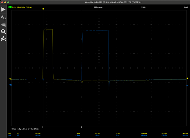

Hi guys,
I've been working with the NRF52832 in the past days and I'm having issues with the GPIOTE interrupts.
It seems that there a latency of around 30us until the interrupt handler is called?
To give a bit of context I'm working with the TDC1000 which is an Ultrasonic Sensing Analog Front End that will return the distance by triggering an interrupt on the stop pin. To calculate the distance I need to have the start interrupt time and use it to subtract with the stop interrupt time. Since it's an 1MHz transducer, it means that 10us is equal to 7mm (10 * 1450 / 2). That's why I really need the interrupts to work with zero latency. In theory if the latency is always the same it should still work since it will compensate when subtracting, but I'm afraid that is not the case. To measure the time I'm using a timer running at 16MHz which should give me enough accuracy (1/16).
The way I've code the interrupts was:

The very first print (elapsed time since the trigger signal and the start interrupt): "TX pulses transmitted after: 30.2 usec" is wrong. I've used the oscilloscope to measure it and it reports 4.4us instead.
But then the stop pulses seem to match the reality which let me think that the latency is always the same which still makes the code to work but it's not ideal.
Calling NVIC_SetPriority seems to have no effect.
NVIC_SetPriority(GPIOTE_IRQn, IRQ_PRIO_LOWEST);
NVIC_SetPriority(TIMER0_IRQn, IRQ_PRIO_LOWEST);
Any other suggestions? Is this an expected behaviour when using Zephyr OS or is this something that can be fixable? I guess that I can try to have a counter instead of the timer, and use the stop and start pins to start and stop the counter?

    This seems indeed to improve a lot the timing. Can you just take a look to make sure that I'm doing everything ok?
    My take was, since I want to read the time that it takes between the trigger command (writing to gpio) and the start interrupt followed by the echos (stop pin interrupt) i've configured ppi to NRF_TIMER_TASK_CAPTURE0. Then on the interrupt handler I'm retrieving the captured value.
    Fernando Fontes
  • Hi Fernando,
    Yes, this is what I had in mind, and it looks good. With this, the interrupt latency does not affect the measurements. Note that depending on what fits best, you can also clear the timer like this so you will get an absolute cycle count between each event and not have to handle the timer wraping around.
  • Hi Einar,
    Yes, I could do that, but I'm cleaning the timer before starting the reading and the time of flight should not exceed 1ms. So, there turn around is not an issue with the 32 bit counter.
    I only have one question left. If I understood correctly ppi will capture the timer value and store it in the timer.p_reg register. Since I'm doing NRF_TIMER_TASK_CAPTURE0, the result will be on CHANNEL0 right? Is it possible that gpiote_event_handler is not fast enough and I could have the ppi capturing the value between two pulses and overwriting the register?
    Fernando Fontes
  • Hi Fernando,
    Yes, that is right. If you trigger NRF_TIMER_TASK_CAPTURE0, the result will be in the CC register for channel 0, and the next time you capture on the same channel, it will be overwritten. There are several channels though, so you could map different events to different capture tasks via PPI (in this case you could map each of the three GPIOTE events to separate capture tasks).
