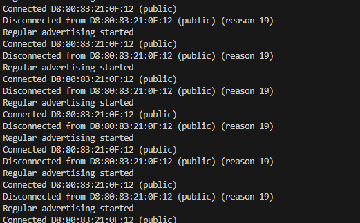

    I: BAS Notifications disabled
    Disconnected from D8:80:83:21:0F:12 (public) (reason 22)
    Advertising with no Accept list
    Advertising successfully started
    Connected D8:80:83:21:0F:12 (public)
    Disconnected from D8:80:83:21:0F:12 (public) (reason 19)

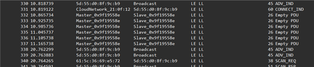

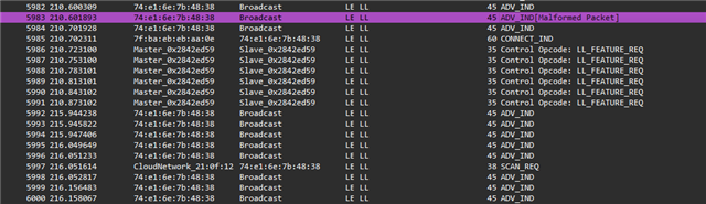

    I've captured packets, but I'm not sure that's it's giving useful information
    I've also seen these packets

  • I've figured out what the problem was. When turning off the BLE from the PC, I advertise using the accept list
    adv_param.options |= BT_LE_ADV_OPT_FILTER_CONN;
    But after pressing the button to clear the bonds I don't remove BT_LE_ADV_OPT_FILTER_CONN, but I've added the else clause which fixed it.
    	if (option != 0)
    		printk("Using filter accept list\n");
    	else
    		adv_param.options = (BT_LE_ADV_OPT_CONNECTABLE | BT_LE_ADV_OPT_ONE_TIME),
    		printk("Not using filter accept list\n");
    Out of curiosity, does scanning the packets show these parameters, because I couldn't see it on wireshark
